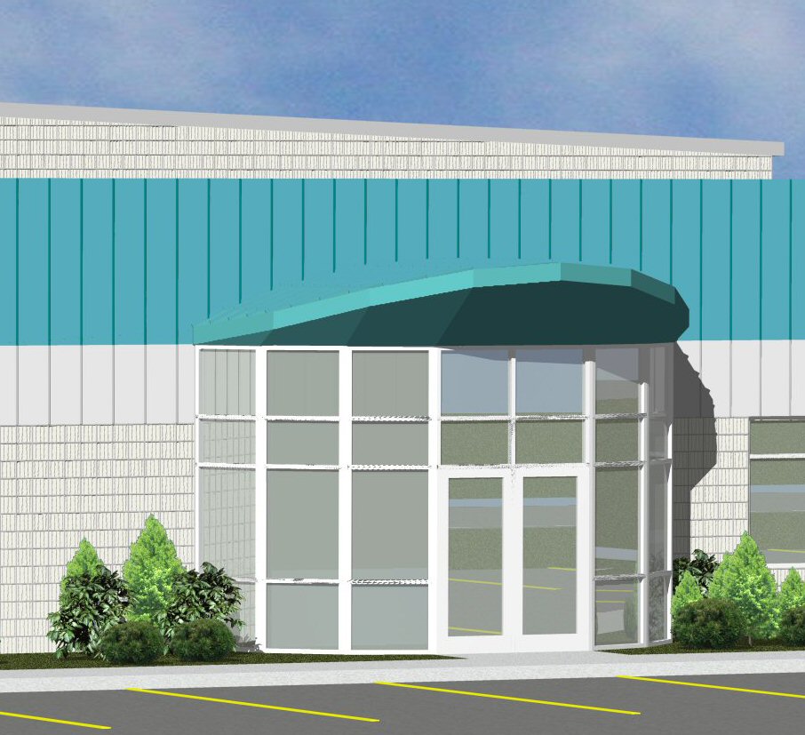

I'm trying to recrate this roof, i think it might have been done in ADT i'm not sure, how can i do this in Revit!

Try doing a Roof by Extrusion. You will need to be in the elevation view to use Roof by Extrusion.  Then go to a roof plan, and draw a void  that will cut the corners off of the roof.  Then do a Cut Geometry.  Without trying myself, this is my best guess.
Cool looking roof.
If the first method doesn't work you can use Roof by Face.  To do this you would use the massing tools to make a face that is the shape you want.  Then, start your Roof by Face and select the face you want.  One of these (if not both) will work.
Good Luck and Happy Roofing
