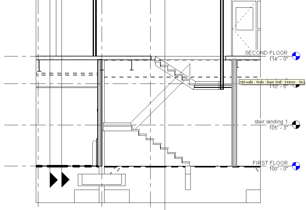

I'm having a lot of trouble placing a stair. I do exactly what Revit tells me to do but there is one major flaw.
 The runner doesn't seem to be at the correct angle on just ONE of the sides (please see picture). Has anyone run into this?
 Please Help!  Thanks in advance for any information and help.

You have to break your green boundary line at landings or anywhere there is a change of angle.
