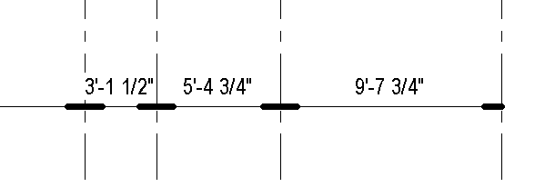

Well, I can get the blasted things to show up . . . but they're flat rather than angled.  DRIVING ME CRAZY!

For what it's worth, revit 2011 has the SAME PROBLEM.  Cool heavy end tick marks . . . but flatter than crap.  I've attached a pic so you can see how wonderful they look.

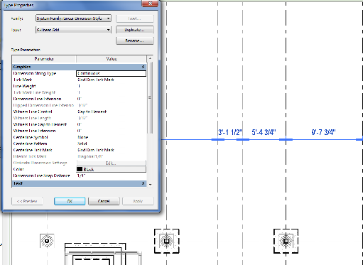

Thu, Jul 15, 2010 at 1:04:05 PM | Heavy End Tick Marks disappear
BigD
BigD Avatar
Joined: Mon, Nov 26, 2007
100 Posts
1 Stars: 1 Votes
Tick Mark Line Weight is grayed out (unavailable option).  Not working in thin line mode (see attachment)

Thu, Jul 15, 2010 at 1:21:42 PM | Heavy End Tick Marks disappear
Bimman
Bimman Avatar
Joined: Wed, Dec 17, 2003
360 Posts
1 Stars: 2 Votes
i have mine set to dia 1/8" and i can set my tick mark line wt.  but when i switch it to heavy ended i lose the abitily to adjust the tick mark.  so what i did was set my tick mark to 6 on 1/8" dia and then switched it to heavy ended and the tick mark line wt is 6.
