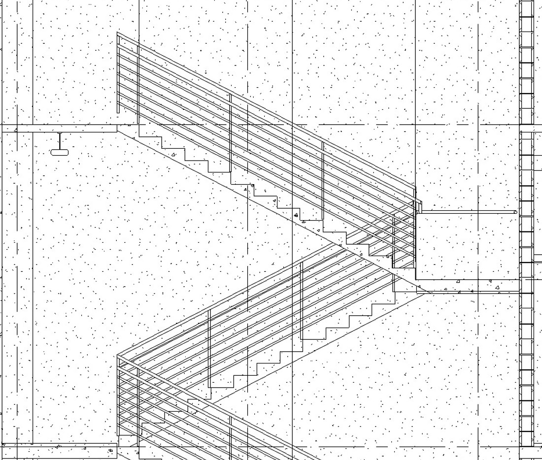

Newbie here in school having problems trying to detail my stairs for a 3 story project.
I can't figure out how to dimension my railing heights off the stairway (Revit will not allow me to pick to railing to dimension). Also my railings don't reach or line up with the stairs (I'd like to detail how are attached). I've searched all over and can't seem to find a tutorial that covers these issues I have. Can anyone help??
Thanks

You need to do an Edit/New on the railing properties to change the offsets on the balusters and/or railings if they don't line up.  Notice there are starting, ending, and middle(?) type balusters that can all be adjusted.
 Sorry, I'm also too much of a newb to help you with the detailing question.
