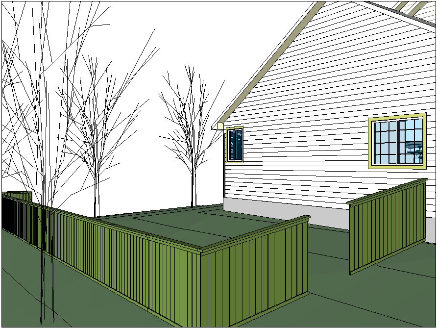

There is apparently no way to create a fence that follows the topography of your site using Revit.  Here's how I did/am doing it.  Warning - this is THE hard way!
First, the type of fence I wanted to make was a 5' high wood fence.
1.  Draw reference planes along the fence lines and name them accordingly.
2.  Create temporary sections adjacent to one of the reference planes.
3.  Go to the section view and turn on "Shading with Edges".  You should now see where the "grass" meets the "dirt", or whatever defining colors there are depending on your site properties to distinguish between above and below grade.  This is now a section looking at where the fence will be, and right at the associated reference plane.
4.  Start creating the fence using Modeling->Create to extrude the components of your fence in place, following the terrain, and operating from the reference planes you inserted.  Being particularly savvy with arrays and the family browser comes in handy (I suppose, because I'm not that savvy with either).  From the section views, I also added some general terrain following reference planes for the top and bottom of the fence, from which I create the top and bottom extrusions.  You may have to switch "shading with lines" on and off in order to see what you are doing.  It's a long process, but this is a brute force method that works.
5.  I have had some success with installing Site based "post" families along a fence line, which will follow the terrain. So you could use those in conjunction with the above to better create the fence.  I don't recommend this method for all of the vertical members, because at least for a wood fence, the tops and the bottoms of the slats won't be contoured to the terrain - they will be horizontal.

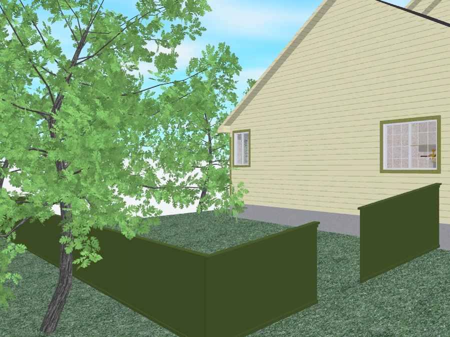

Thu, Mar 8, 2007 at 12:36:52 AM | The Hard Way to Create a Topo Fence - But it Works.
Enginator
Joined: Wed, Feb 21, 2007
40 Posts
5 Stars: 2 Votes
Here you go. Rendered version isn't that great, but you get the idea.   That was my first time through.  Again, I'd probably get my sections a little closer to the reference plane next time and use site based metal posts on the inside.
