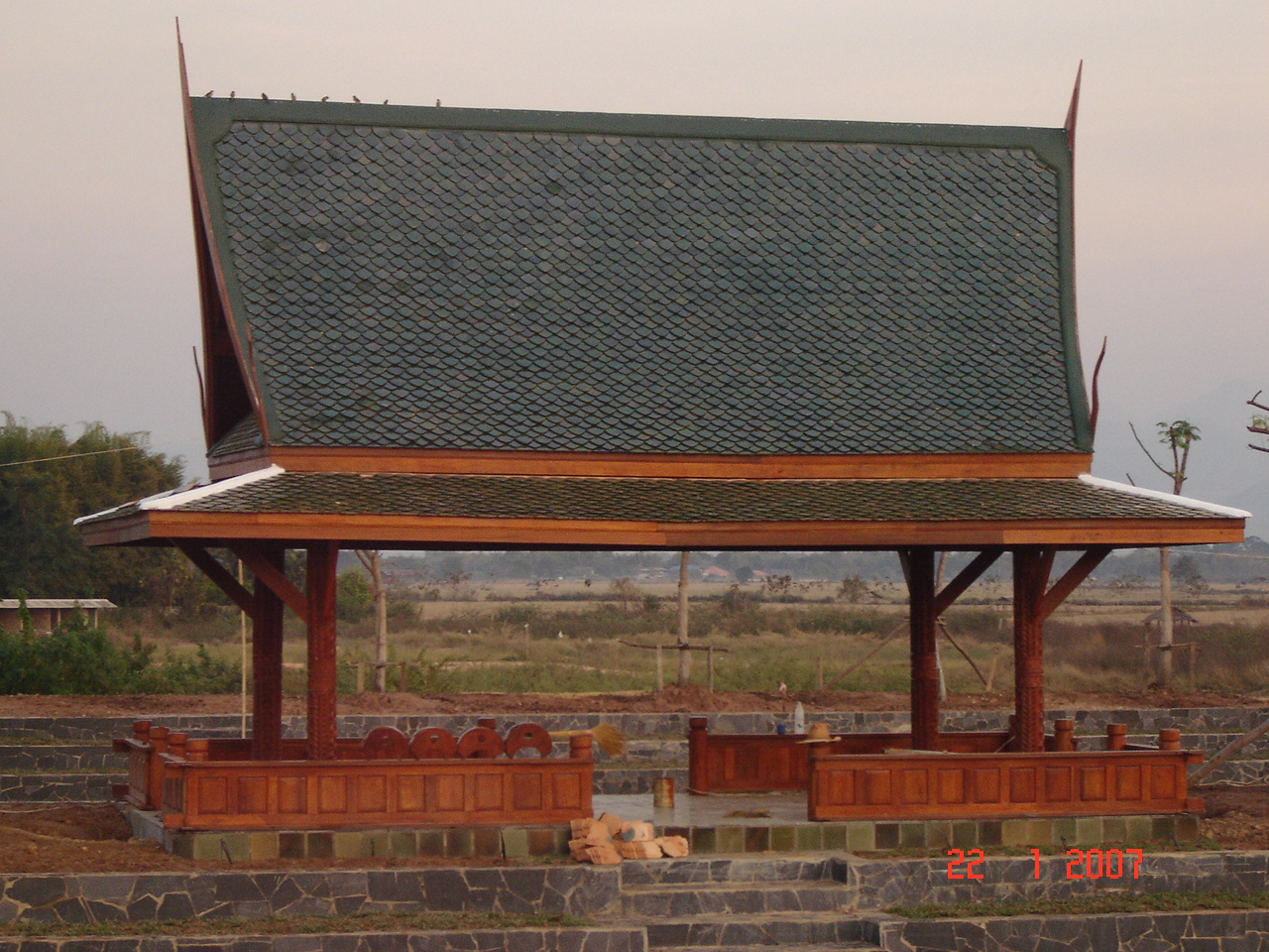

Hi all,
I try to many way to create Roof fascia on curve roof. Roof Fascia it don't work.
It will create on straight only. Please help me how the way to do by Revit.
( Now i export this roof to sketchup and create by follow me command and import to Generic model family )
Thank you,
Golf.

I think I would make this roof element as an in place family and use a void extrusion sweep or revolve to cut the curves out of the gable piece.  I'll make an example when I get Revit back up.  Right now I'm updating to the latest build.
