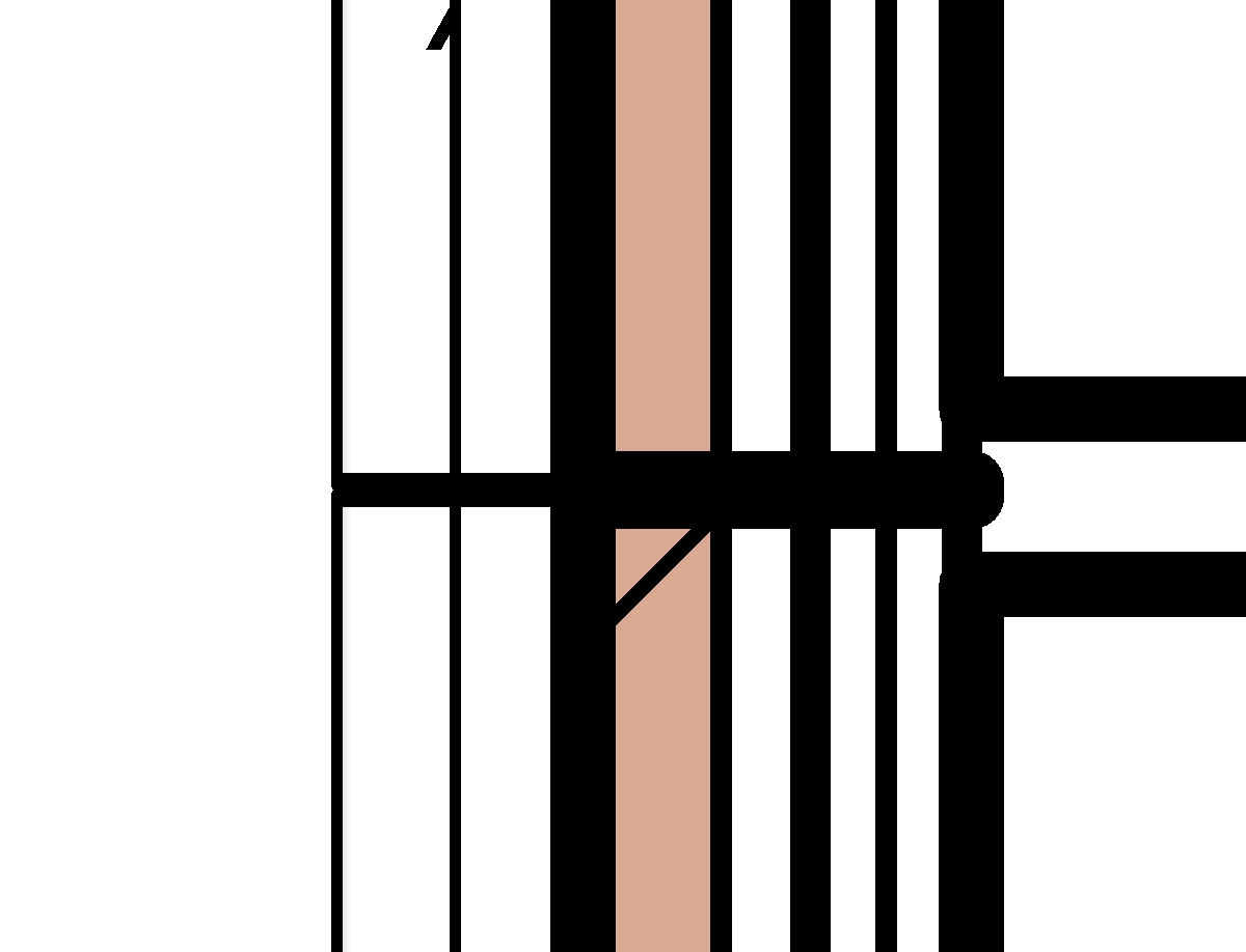

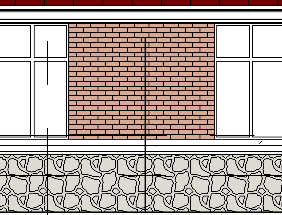

To create a control joint "gap" that will show up in my plan and elevation, I used the "opening" option under the modelling tab and cut the opening in the wall in plan.  Works great until I noticed that the opening topped out well short of the top of my wall in elevation and in 3D viewing.  (See attached images.)  The exterior wall is a stacked wall but the opening doesn't stop at the beginning or ending of any of the stacked walls.  Why does Revit do this kind of crap to me?  What have I done to deserve it?

Don't split your wall - use a vertical wall reveal.
Fri, Feb 16, 2007 at 3:21:05 PM | I finally figured out that I could right click on the "opening".................

....................and set the opening height at whatever I wanted.  That took care of my problem.  When you say do a "vertical reveal" is that a different process than cutting the opening in the wall in plan?  Are you cutting it in elevation or is this something else entirely?  Thanks for the help.

In elevation and the modeling menu, select "Host Sweep", "wall Reveal" and choose the profile you want.  (You will probably have to create the one you want but use something that's already there to check out the process.)
If this is a construction jt in masonry, you might model this as a shallow 'V' .  You could also model it as a positive wall sweep that is the full depth of the masonry - the thickness of the sealant and color or material approprite.

On the modeling tab>host sweep>wall reveal on the bar above your screen it will say horizontal or vertical. I just tried it on a stacked wall with a ½"x½" profile. You have to click on your stacked wall twice, once on the bottom material and once on the top.....THEN click start next. That's my wishlist pet peeve (the start next thing)

Sun, Feb 18, 2007 at 8:31:44 AM | Thanks for the advice. Works great!

I hope the attach wall thingy isn't a major cause of how huge Revit files get cause I really like being able to change my roof level and having all the walls follow automatically.  That wall opening in elevation works great.
