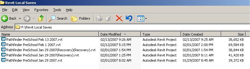

Tue, Feb 13, 2007 at 11:19:22 AM | Here is a print screen image of Windows Explorer showing the two "saves" :
Hogmodo
Hogmodo Avatar
Joined: Tue, Jan 6, 2004
367 Posts
3.5 Stars: 6 Votes
Does this answer the question?

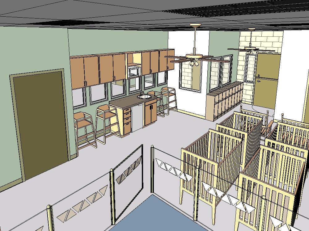

Tue, Feb 13, 2007 at 11:23:53 AM | Here is a shading with edges 3D view of a daycare room.
Hogmodo
Hogmodo Avatar
367 Posts
3.5 Stars: 6 Votes
This is the type of stuff in the job but, again, it is in both the 38meg and 69meg saves one done late one day and the other done early on the next.
