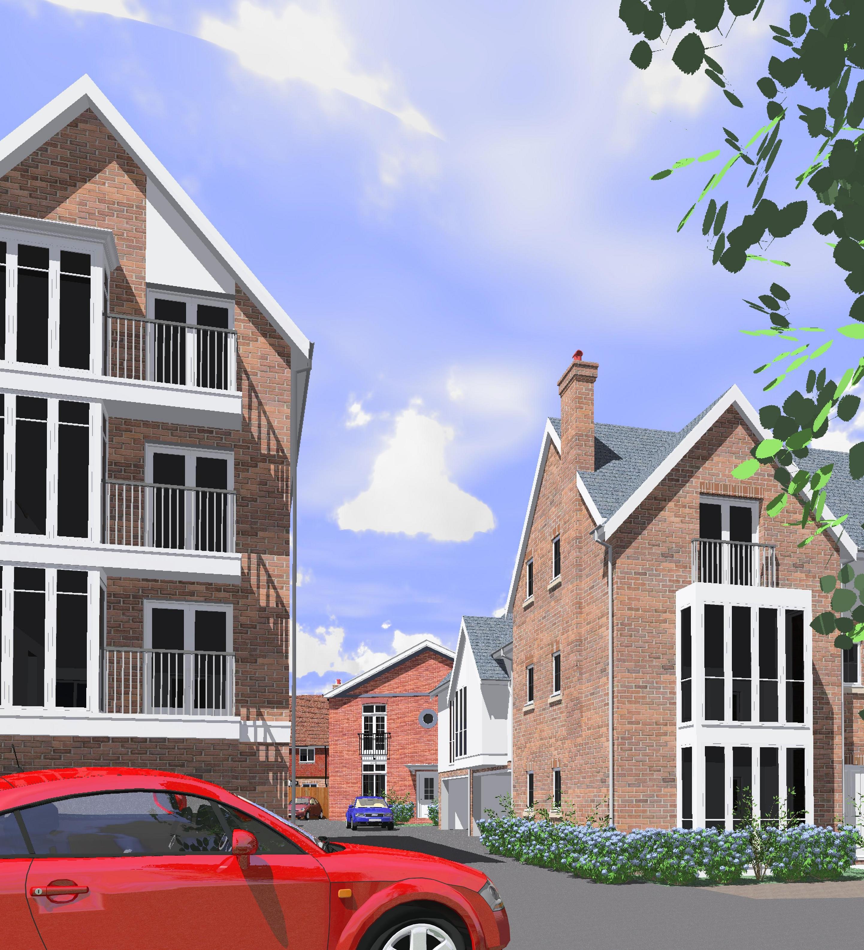

Apologies for the darkness that has descended upon the revitcity website. I'm not sure the image is really worth waiting for! For those who are interested, I will attach to this message, maybe that will work........

Wonderful ~ nice bit of Brit accurender there Apart from everything else how was the sky done ~ ie line top left through clouds?

Thankyou. The rendering was considerably easier than posting it on the gallery! The sky is bog standard out of accurender. Go to the render settings, environment, pick a solid colour (nice light blue), then tick the clouds box in advanced. Go to the clouds tab that appears and tick sheet clouds, haze at horizon and 3d clouds. Play with the number of clouds but that one was set to 300. The line through the clouds was more luck than judgement. One of my colleagues suggested a vapour trail because of the proximity to London, I'll have to work on that!
