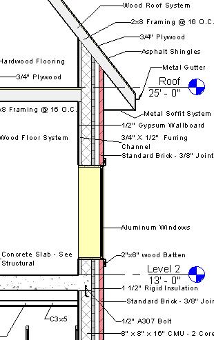

I recently spent a little time digging into the Keynotes aspect of REVIT 9 and I have to say.
Wow ! That was far too easy. Why is everyone not using these?
Below is a link to a CADclip on how easily you can put Keynotes to work and gain a ton of time.
(right click and 'Save Target As.." to download)
I've also included a sample image of what I did with Keynotes.

Does one have to add the information to each item for it to keynote?  If you have meticulously a structural plan, made of elements which have properties including a type value that identifies it accurately ("W10x29"Winking, do you have to select each element and then assign the keynote? there are a daunting number of (smart?) elements in a building, you have to go in a keynote every one to use keynoting???
(there should be...) Is there a master table of keynotes that can be selected in settings>kenoting that already knows what all the elements are (since almost all revit building components already have plenty of info about themselves? )

Steve, that is a regular Tag (by catagory) not a keynote. And yes it is all built in.

What tag woud be used for structural members, Cryingwhat folder is it in?)
