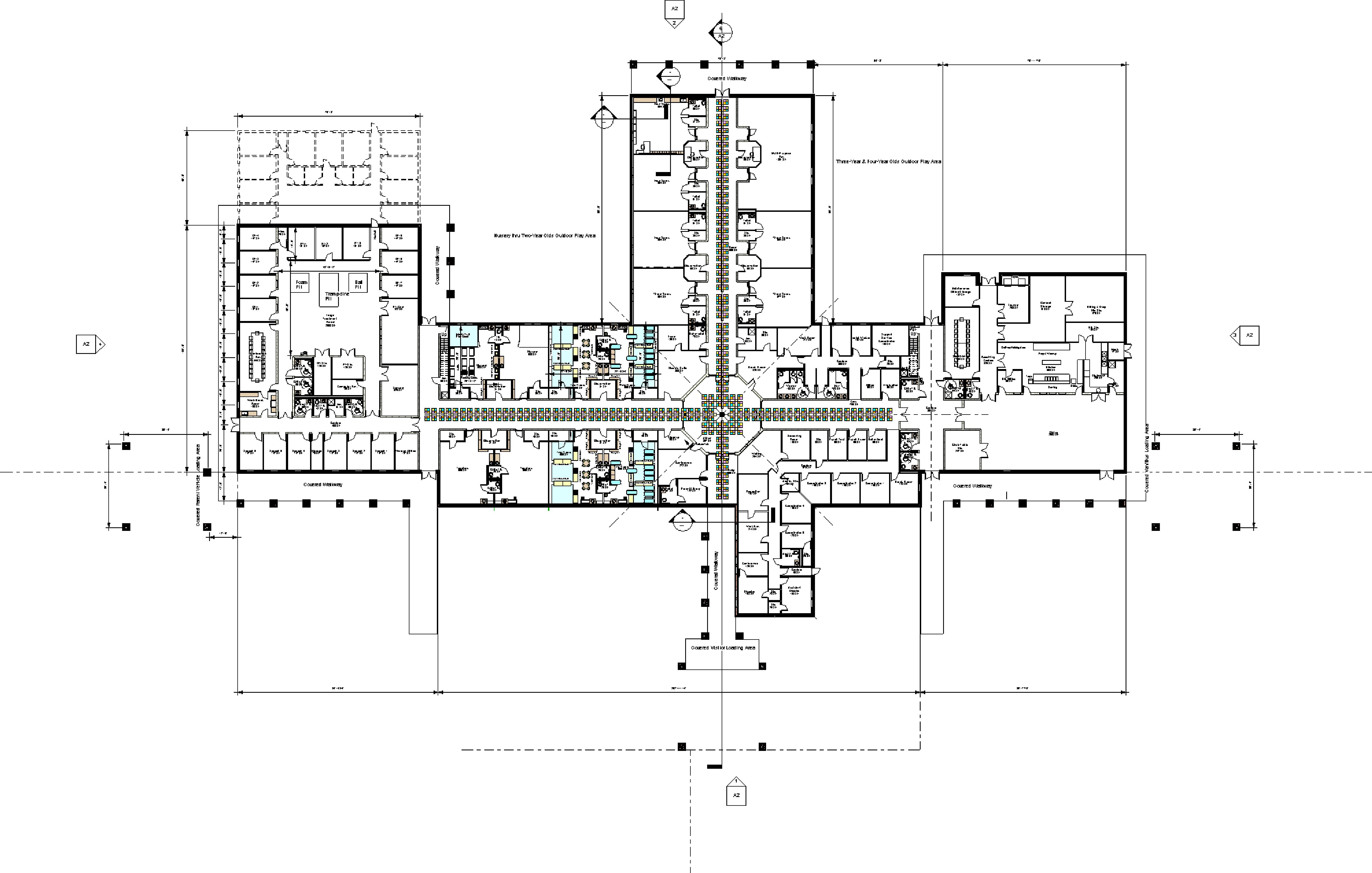

I have taken the same wall and broken it with 3/4" wide gaps to simulate wall control joints.  They then read in plan, elevation, and 3D and it makes a simple callout for detailing.  I take two lines, 3/4" apart and multiple copy them along one long wall.  I split the wall, trim to the line, no problems, then all of a sudden it won't work anymore.  I can't get the ends of the walls within 4" of each other without the walls joining.  I have deleted the two crazy walls and copied two walls that divided correctly into that spot and the good walls turn into crazy ones.  Why do the gremlins in Revit hate me so much?  Anybody got any suggestions?  Other than quit worrying about it and draw one long wall with no breaks!
 See attached image.

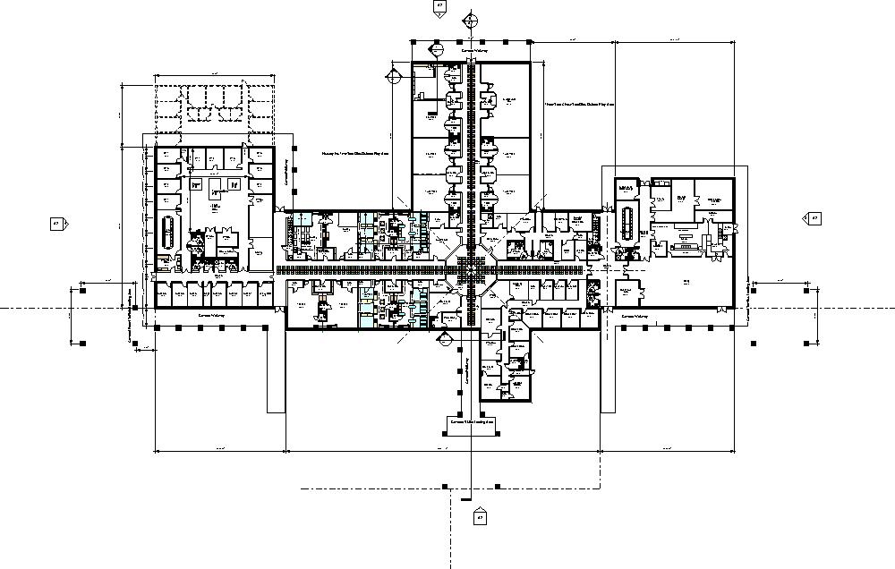

Mon, Feb 5, 2007 at 5:20:53 PM | Oooops! Wrong image. See new attached.
Hogmodo
Hogmodo Avatar
Joined: Tue, Jan 6, 2004
367 Posts
3.5 Stars: 6 Votes
x
Mon, Feb 5, 2007 at 5:23:07 PM | One more time.
Hogmodo
Hogmodo Avatar
367 Posts
3.5 Stars: 6 Votes
2nd Image was kind of crude.  Here is one with 5 times the pixels.  Hope it works this time.

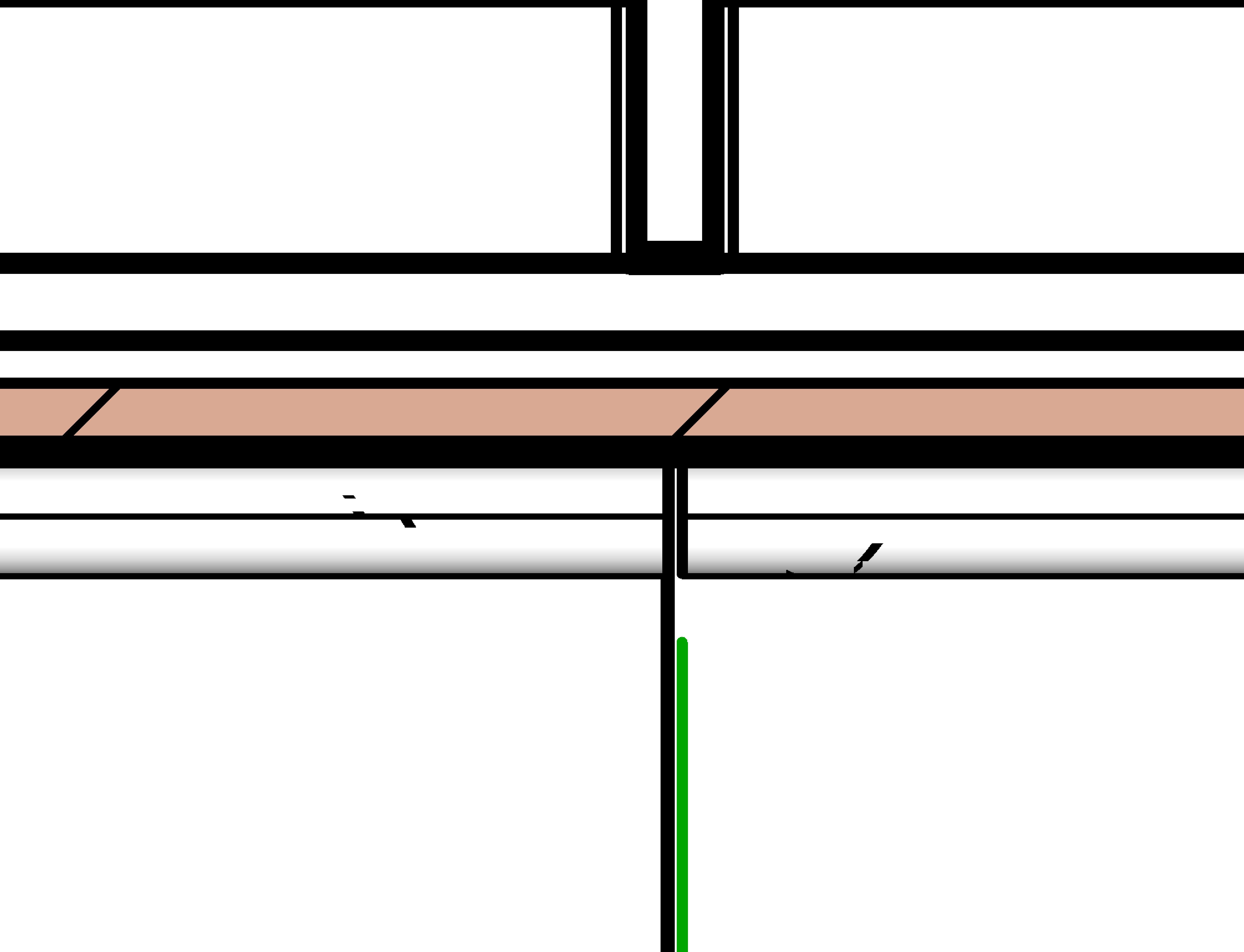

Mon, Feb 5, 2007 at 5:25:04 PM | Maybe it's not Revit, it might be me. One more time.

 if you are trying to keep the walls from joining
try selecting your walls, right-click over the blue-dot at the end and select "disallow join"

Tue, Feb 6, 2007 at 7:36:17 AM | Thank you very much! Now......................
Hogmodo
Hogmodo Avatar
367 Posts
3.5 Stars: 6 Votes
....................if you can tell me how to get my HP Plot Drivers to let me plot sheets directly from Revit, I will forever be in your debt.
 One question:  Why would part of the same wall have the "connect wall selection" on and another part not?  Is there some little thing I did that triggered this that I am not aware of?

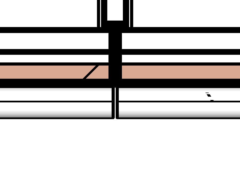

Tue, Feb 6, 2007 at 8:08:57 AM | I still got problems with that "disallow join" thing!
Hogmodo
Hogmodo Avatar
367 Posts
3.5 Stars: 6 Votes
In the image attached, you see one of those places that I want to create the 3/4" split in the wall.  Despite the fact that both walls have the "disallow join" selected, the left hand wall keeps joining with the right.  Since the right hand wall was behaving properly, I deleted the left, mirrored the right over to the left and it started doing the same thing!
These are stacked walls.  Is there something in the three wall types that I stacked to create this stacked wall that could flop around occasionally and create the "joining" problem despite the "disallow join" being selected?  Notice that part of the wall IS split correctly.  This is the base of the stack which contains a pre-cast concrete sweep on top of stone.  The sweep is what you see on the front of the wall that is split.  The second level of the stack is a brick on met stud wall.  IT is the one "joining when told not to." Up above the cut line is a siding on met stud wall (for the gables) but I assume it is not the culprit since it is not visible in plan view.

Tue, Feb 6, 2007 at 8:30:33 AM | Why do Revit walls hate me?
The wall clean-up issues you are having are a problem because I think you are making a mistake doing your wall control joints as you are.  If you want a control joint that shows up in plan / elevation & 3d, use a wall reveal.  Then you won't have the wall clean-up issues.
Tue, Feb 6, 2007 at 10:47:56 AM | A vertical wall reveal? How does that work?

Tue, Feb 6, 2007 at 4:28:45 PM | Why do Revit walls hate me?
#10
puzzle
Joined: Mon, Sep 19, 2005
217 Posts
4 Stars: 10 Votes
Would it be a better option to make the control joint using a void. This way the wall would still be one and you would have no join issues.

Tue, Feb 6, 2007 at 4:33:39 PM | Why do Revit walls hate me?
#11
Reveals can be vertical or horizontal - look at your status bar.
