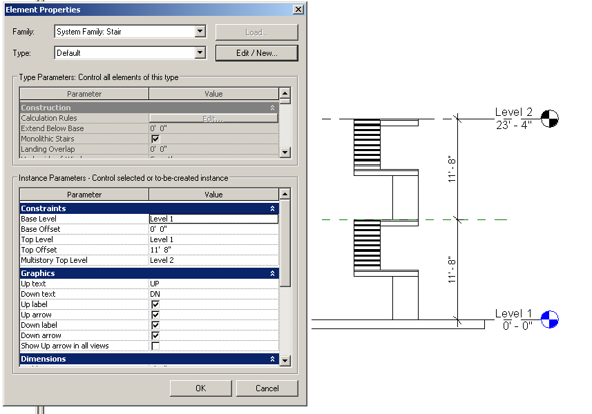

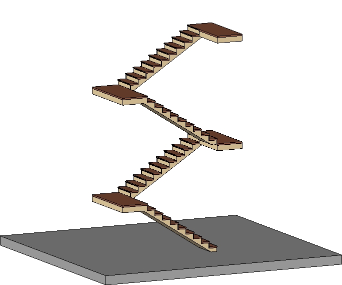

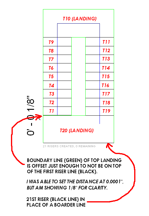

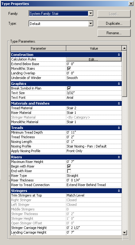

I just managed to create what I think HTrick was getting at: A run of stairs with intermediate landings that are part of the stair, not a separate floor.
The images show the end result, with the settings and sketch.
There are a couple of tricks required:
1. Uncheck "end with riser" in the Type Properties.  This allows the final riser to be used as a boundary for the top landing, essentially creating a giant top tread.
2. Use the monolithic setting.  I couldn't get the stringers to behave properly.
3. To avoid the error messages about closed loops, overlapping lines, etc. Draw the lines as close as you can to each other keeping a tiny space between them.  I was able to get a boarder line within 0.0001" of a riser line.
I'm still using version 2008.  I don't know if 2009 and/or 2010 have better stair creating capabilities.
