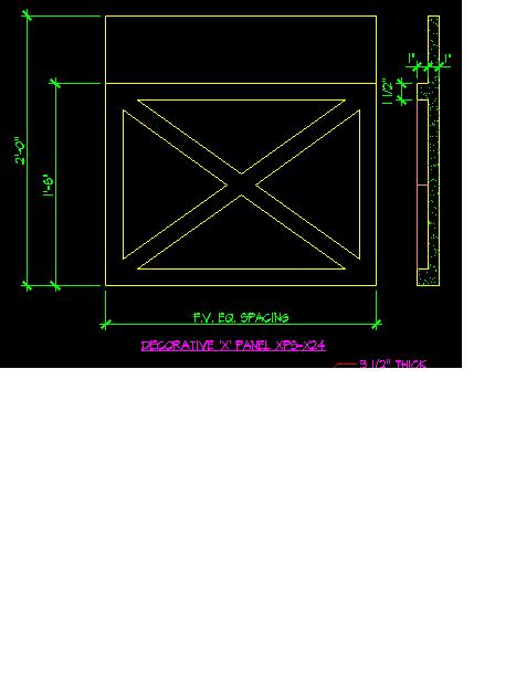

Wow, this is great.  Tinkering with yours and trying to re-draw it myself it appears that the order you draw things impacts wether or not things will stick.  Ref planes first then ref lines works most of the time but doesn't oftern enought to be frustrating.
Based on your model I made a new one that is basically the same but constrains the angles to 45 degrees (attached).
 Do you have any tips that make the corners of the reflines stick to eachother or the ref planes easier?
Hopefully I can use this same strategy on some x pattern brackets later today (Attached).
