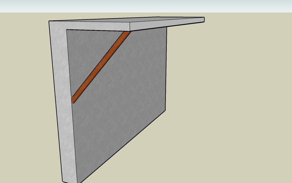

Hi. I want to rotate a column so I can attach it to a roof from the wall at an angle. Check this drawing to see what i mean.
I tried rotating it but get an error saying that i cant rotate that object.
 Any help please?

If your using structural elements, try using a brace instead of a column.  You should be able to choose the same column.  Otherwise, I have not been able to rotate architectural columns or structural columns.
