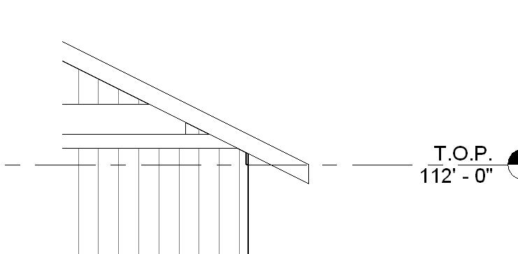

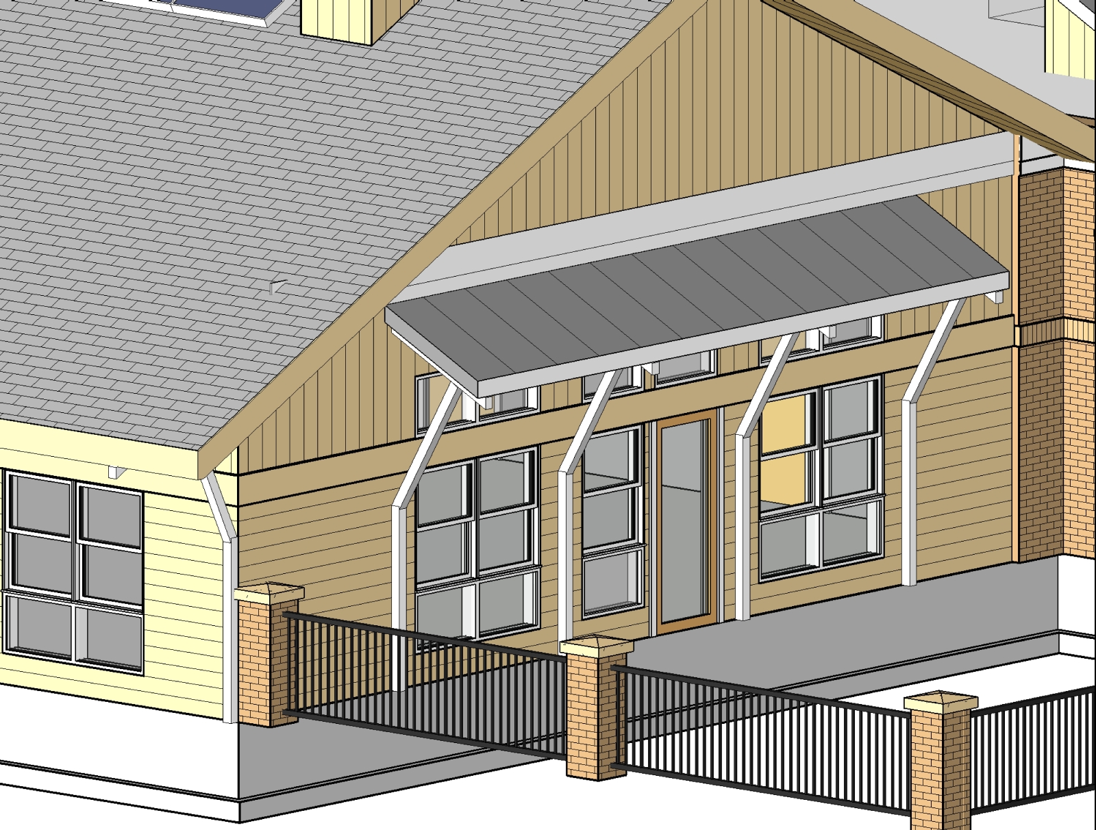

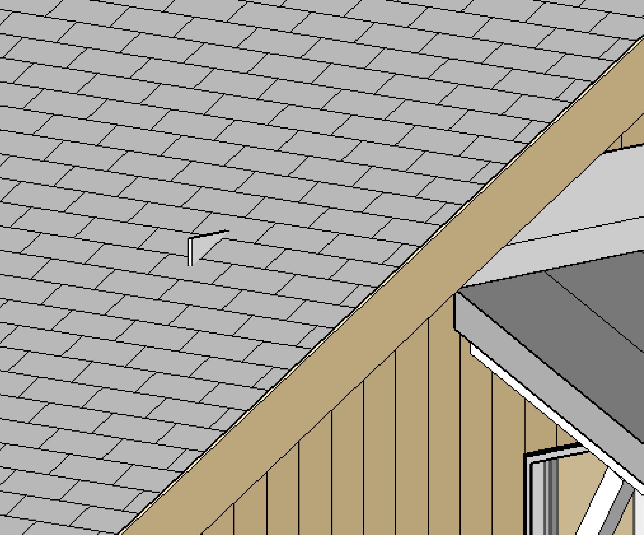

I have some trim on the side of a building that is just high enough that when it reaches the end of a wall it sticks out above the roof. See the attached file.  Is there a way to edit the profile of a wall sweep?  If I could just get the roof to cut the trim and remove the extra, I would be happy.
As always Thanks for the help.

I tryed to click on the trim and then drag it back until it was no longer poking through the roof, but now I can see that the bottom edge doesn't go all the way to the end of the wall.  Is this the method you were referring to?  Does anyone know how to get the best of both worlds?  I would like the trim to go all the way to the edge of the wall without poking through the top of the roof.

Well those photos didn't really tell the story.  Sorry.  Here is the hidden line image again.
