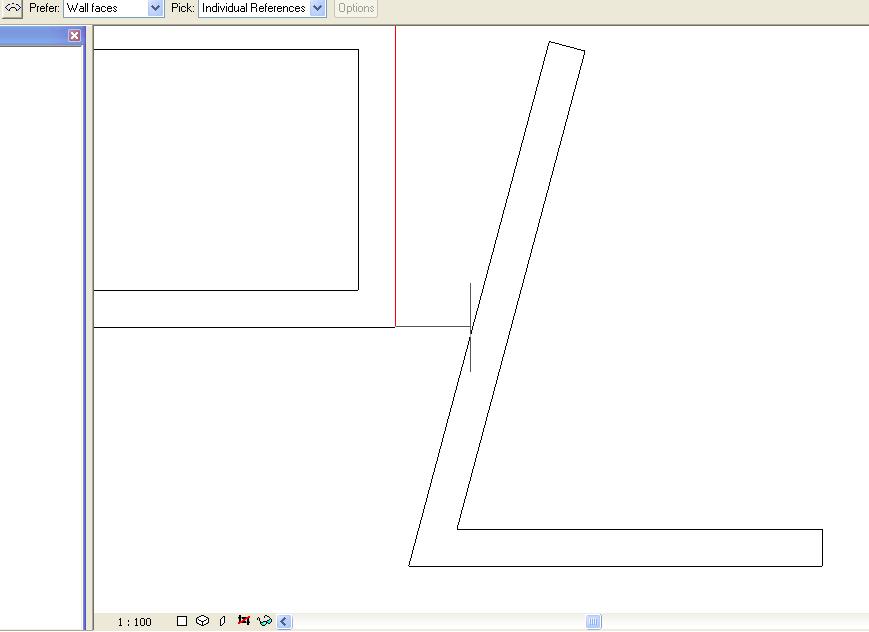

Wed, Jan 17, 2007 at 5:09:44 PM | dimension between 2 unparallel walls

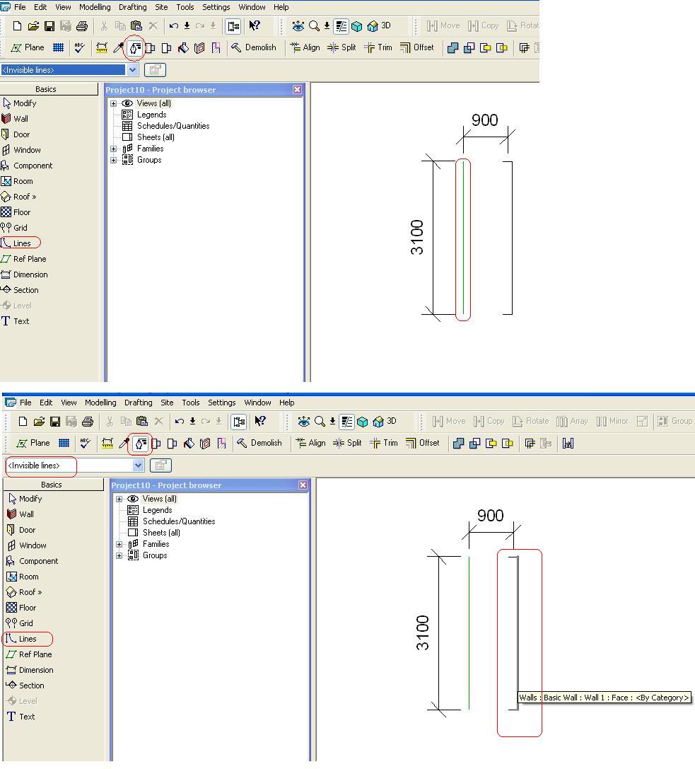

Wed, Jan 17, 2007 at 5:37:48 PM | dimension between 2 unparallel walls
#9
ZULUGIRL
Joined: Mon, Jan 8, 2007
6 Posts
some Kind of an error sound
Wed, Jan 17, 2007 at 6:00:31 PM | dimension between 2 unparallel walls
#10
ZULUGIRL
6 Posts
Look at the picture please.
In the first picture I hovered over the line and it didn't accept the linework command
In the second one I hoverd over the wall and it highlighted.
I've circled in red all the commands  I have used
Wed, Jan 17, 2007 at 6:16:59 PM | dimension between 2 unparallel walls
#11
framerman
Joined: Tue, Jun 29, 2004
543 Posts
4 Stars: 13 Votes
sorry, my fault. I thought for sure I had it set somewhere in my file.
You can make a new line in settings and make the color white so it won't print, or you can move the dimension over the top of the line to appear as one.
try those out and see if it works for you

Thu, Jan 18, 2007 at 11:09:41 AM | dimension between 2 unparallel walls
#14
rkitect
rkitect Avatar
Joined: Thu, Dec 16, 2004
792 Posts
4 Stars: 29 Votes
ZULUGirl:
See the attached image.  You can dimension directly between two walls like you are showing.  Just select the angled wall first then select the corner of the wall which makes the pass you want to dimension.  If the corner doesn't select, hit TAB a couple of time till the point you want to dimension to is selected.  It should select automagically however since it won't dimension to anything else but a point on that wall.  This is, of course, assuming that there is a corner to snap to, I would imagine if there were no corner, however, that there would not be a pass between the buildings.
Also, ZULU, be sure you change the name of the KeyboardShortcuts.txt file that you download to just KeyboardShortcuts.txt .  Revit will not recognize the file "19705_KeyboardShortcuts.txt" as a valid file.
HTH and good luck!
