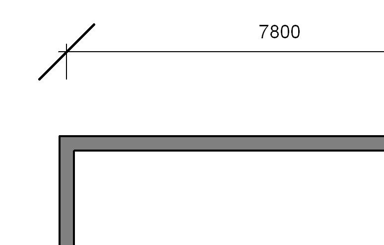

vcen i am facing the same problems with dimensions....
we have this various types of "ticks" in the properties of dimensions like arrow, dot, and diagonal ticks.....what if i want a diagonal tick of different dimension then what is present in the list...

Go Settings-->Annotations-->Arrowheads and there you can make whatever tick size you want.
