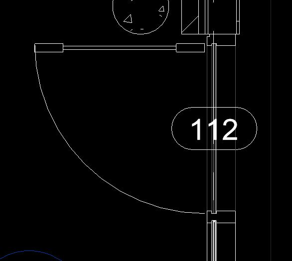

DId you ever get this? I am trying to find a door that looks and acts real. I am using the Tubelite system but can't find a door that works right. This is what I get.

Still looking for a door that fits inside the mullions like in real life. Why is the door bigger than the opening?

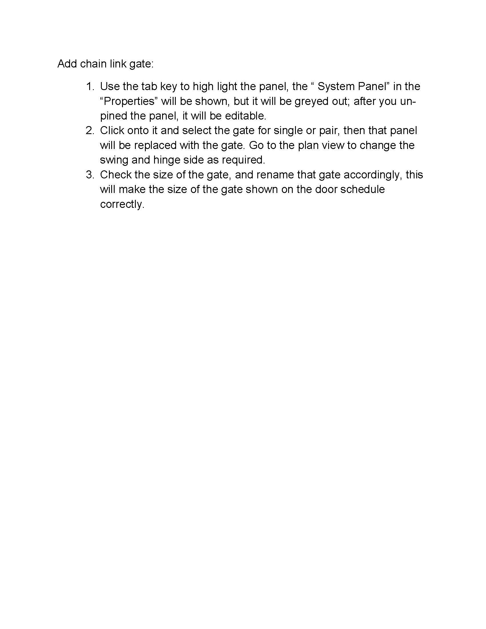

The curtain wall/storefront doors are very tricky.
Please see the attached step-by-step tip with a single chain link gate, which is in 2020.
Hope they can help.

Thanks that helped!
