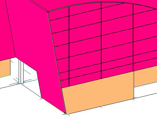

Please have a look at the attachment. 2 questions related to it: 1. How to get a proper joint for the wall and the create in-place wall family (slanting wall)? We tried joint geometry but seems like it still can't joint properly 2. It is true that groove line can not be drawn on Create in-place wall family (slanting wall) using host sweep > wall reveal technique? and why? Is it should be regards as wall too? Thanks & Regards

1. It looks as though your walls are overlapping. Edit the slanted in-place wall family and drag the end so it butts up against the adjoining wall without overlapping it. 2. Yes the host sweep technique will not work on the wall. I would go back into the in-place wall family, set the face of the wall as the work plane and apply void sweeps of the same profile in the appropriate positions. You could also create specific voids and use the cut geometry tool on the adjacent, intersecting wall to have the reveals wrap around the end of the wall.
