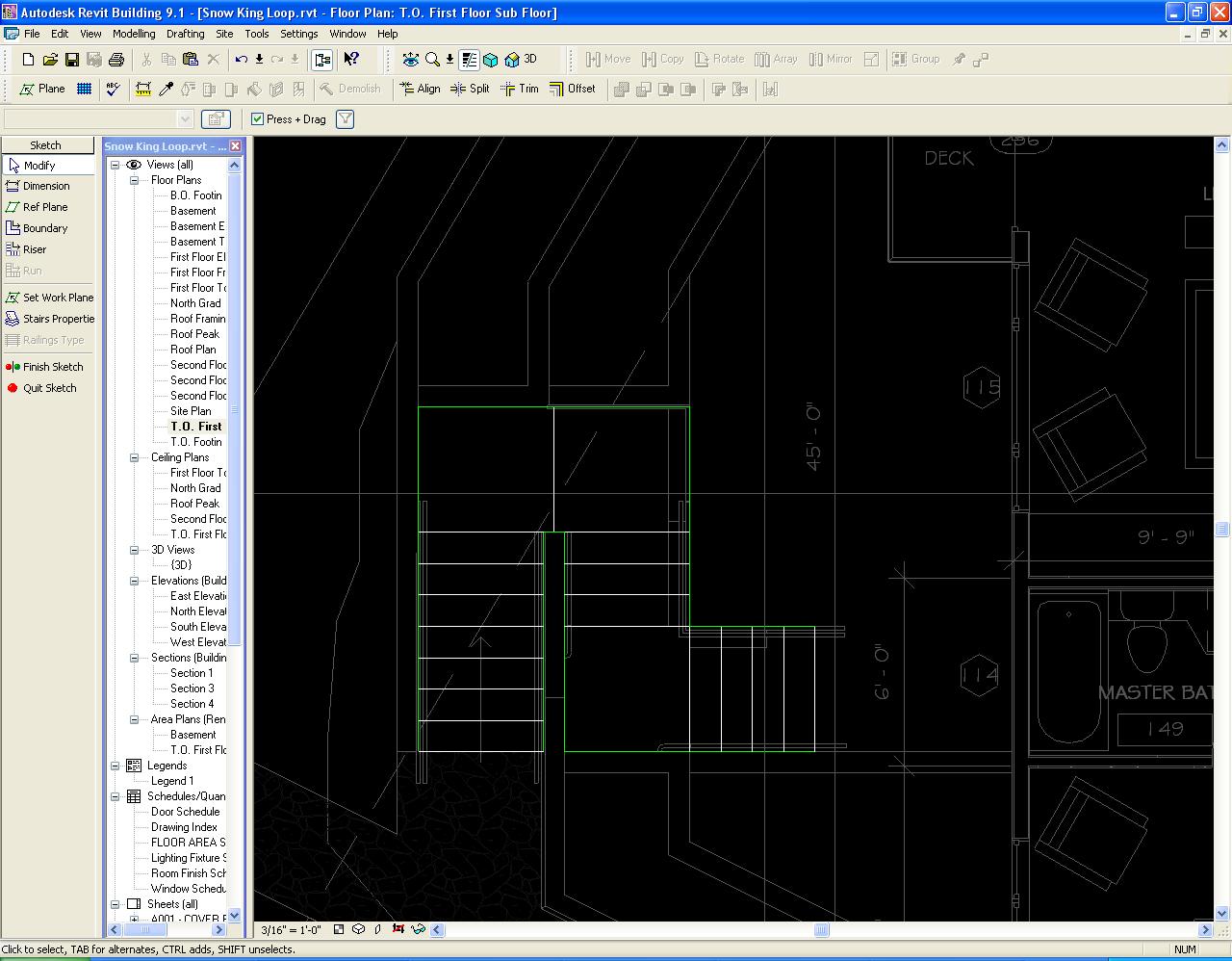

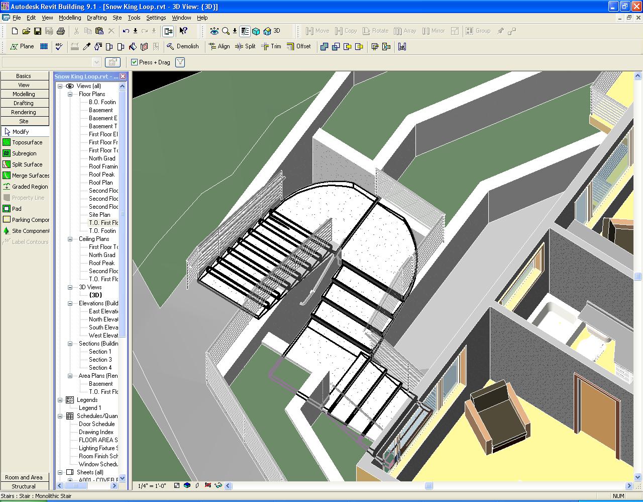

I am trying to creat a staircase using boudaries and risers.  I can construct the staircase, but when i finish it, revit trims the corners off of the winders (see pictures).  I have tried splitting the boundaries, but have not had any luck.  It must have something to do with the way I am construction the stair, but do not have any idea what is causing this.  Any suggestions?

I think it is because you have the one riser splitting the platform.  Revit thinks each side is a tread and that you are making a circular tread. I'd try this as two seperate platforms one riser apart.
 BTW - Where are you?  A single tread like that was always called a trip here.  I don't know if it's allowed in the IBC because I've never tried it.

I agree.
your problem is the tread in the middle, get rid of it, you will also have problem with your balustrade...
