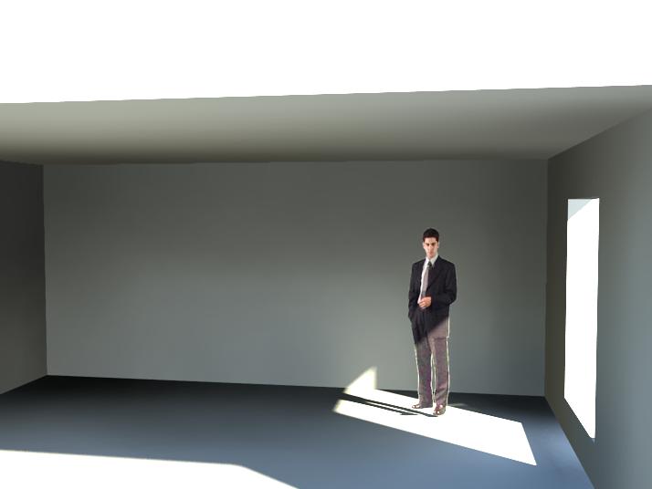

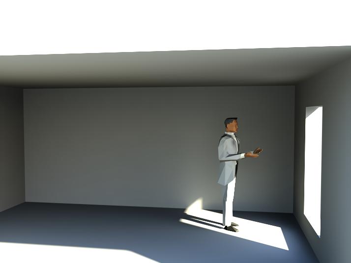

okay bond- compare these two guys- one is RPC and the other
is a regular guy.. notice the RPC is supposed to be standing
on the floor but it never looks right because it's only an image..
also look at the way that image gets exposed to the light coming
in the window.. now look at the other one..
RPCs are great for trees and shrubs- but not much else in my opinion..

The image of the regular guy looks really blocky....no bueno in my opinion.  The issue you state with the RPC not looking like its touching the ground is and easy easy fix.
Two things:
1. You do not have the RPC set to the right host plane
2. You can simply change the level height to -1" or whatever you need.
Very easy to use.  Revit does have a pretty extensive landscape RPC package but that is where is stops.  It would be very very very helpful to many users if they added more people and vehicles rpcs....and why revit has not done that over the years really confuses me.   I try to make a complete product with revit rendering and not use photoshop but i find myself always messing around with photoshop to add people.  Very frustrating.
