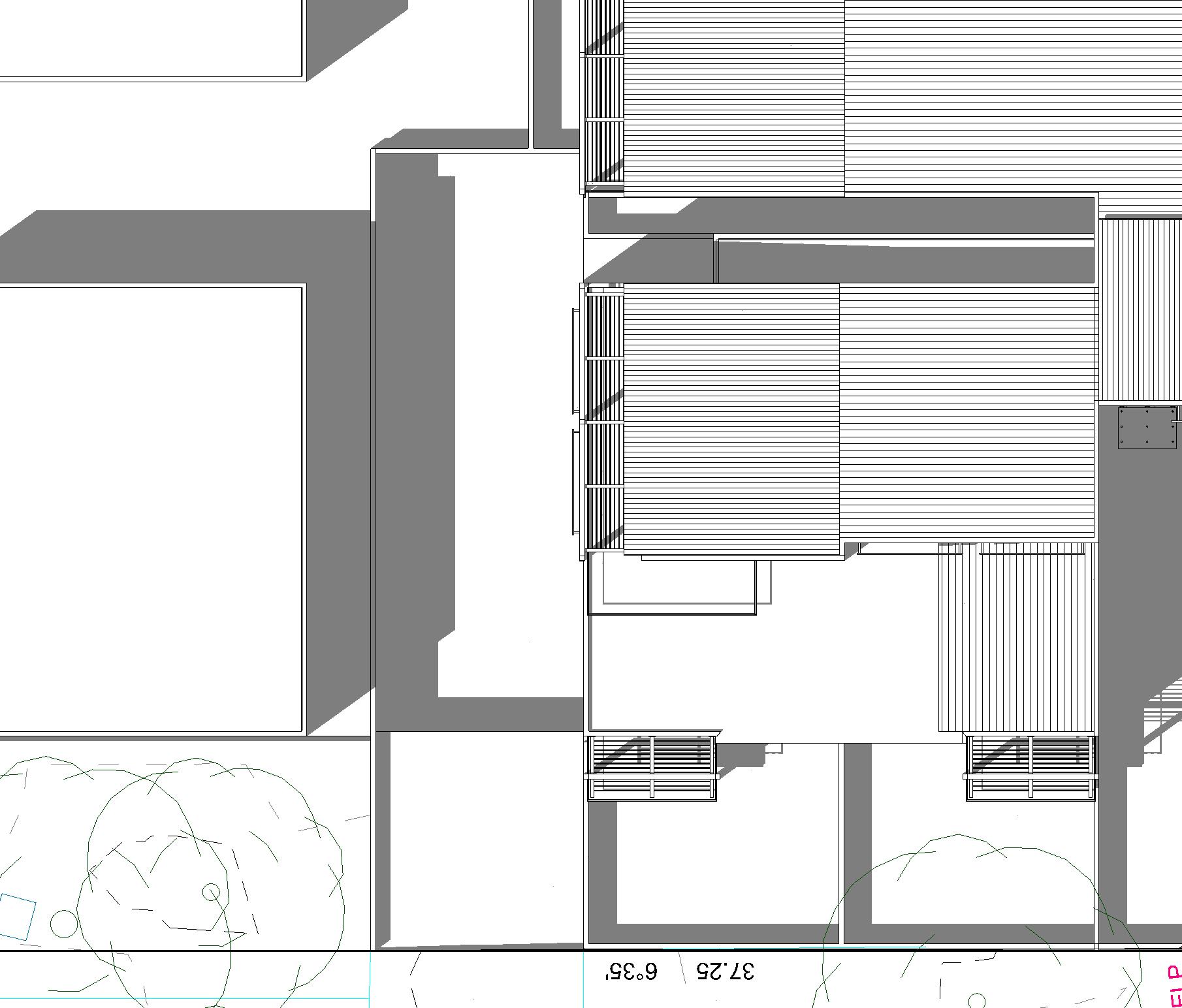

I am hoping someone can help - I cannot seem to get shadows to recognise the ramp to a basement in this multi-residential building (see attached). The ramp is 'visible' in the settings. Any thoughts?
Wed, Nov 29, 2006 at 9:39:08 PM | shadows on ramps
katia
Joined: Thu, Feb 23, 2006
5 Posts
Go into the Advanced Model Graphics and into the settings for the Sun and Shadow Settings and change the Ground Plane to a level situated under / below  the one you are working in.
