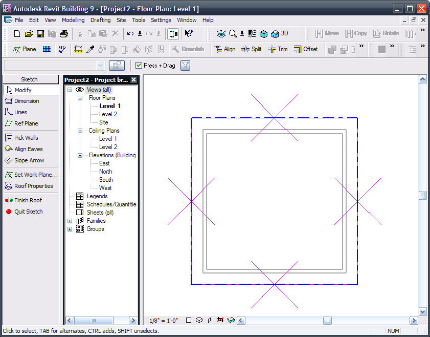

Revit needs more of everything residential.  Sloping roof options need to be improved and simplified. I can't ven do a square tower with four gables very easily.  I have to create two through gables and then make four cut openings because the program 'doesn't get it."

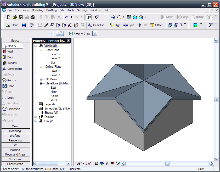

four sided gable like this?  easy!  Just use slope arrows instead of slope defining lines.

I was going to suggest the same thing about the slope arrows.
