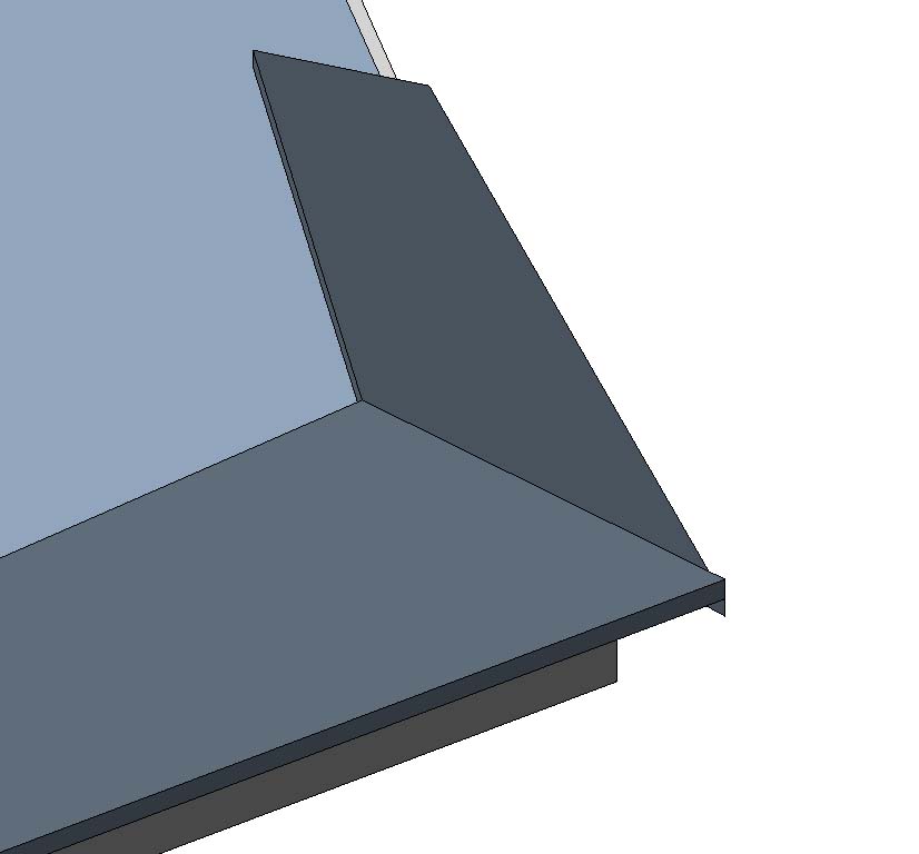

I'm having a difficult time with this roof/roofs. I've attached a roof plan and south elevation of the building and the revit file. I've tried manipulating the roof and tried to create masses (with solid/void extrusions/blends) I wasn't able to get the masses to join therefore not being able to attach a roof to their face. Any help or suggestions would be appreciated! Thanks!

OK, this is what I did. I just made a regular roof. Roof>by footprint. Used lines for the end of my fascia part. Then I used the opening command for all the zigzag lines on the ridge area. Looks like you have 5 separate roofs to make there. I also used the opening command for the end of the roof (fascia edge) to make it rake uphill like you show.

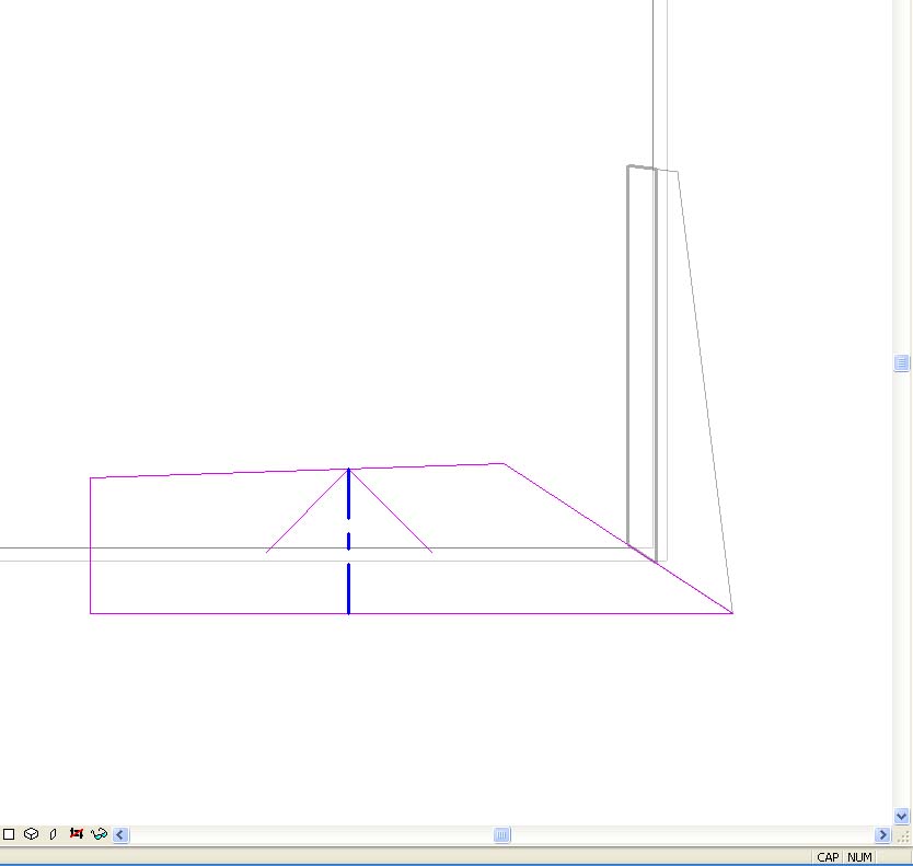

I did try the same technique they were using but only did one slope arrow and created each plane separately.  I've attached what I got. I do have that troublesome corner condition now. I am not able to join or cut these too planes together. Do you know how to solve this?

your two roof planes don't match on the bottom (hopefully this is what you want to accomplish). from the plan view, your hip rafter will be a different angle. I'd go into the elevation view and match the edges of your roof tails first, then what you can do is edit the roof to extend past each other. you should be able to join geometry, then you can trim the roof lines back to where they belong. when I adjust my roof, i select the roof, hit edit, then adjust the lines. if you cant join geometry on the two, you will have a really hard time making the roof right.
