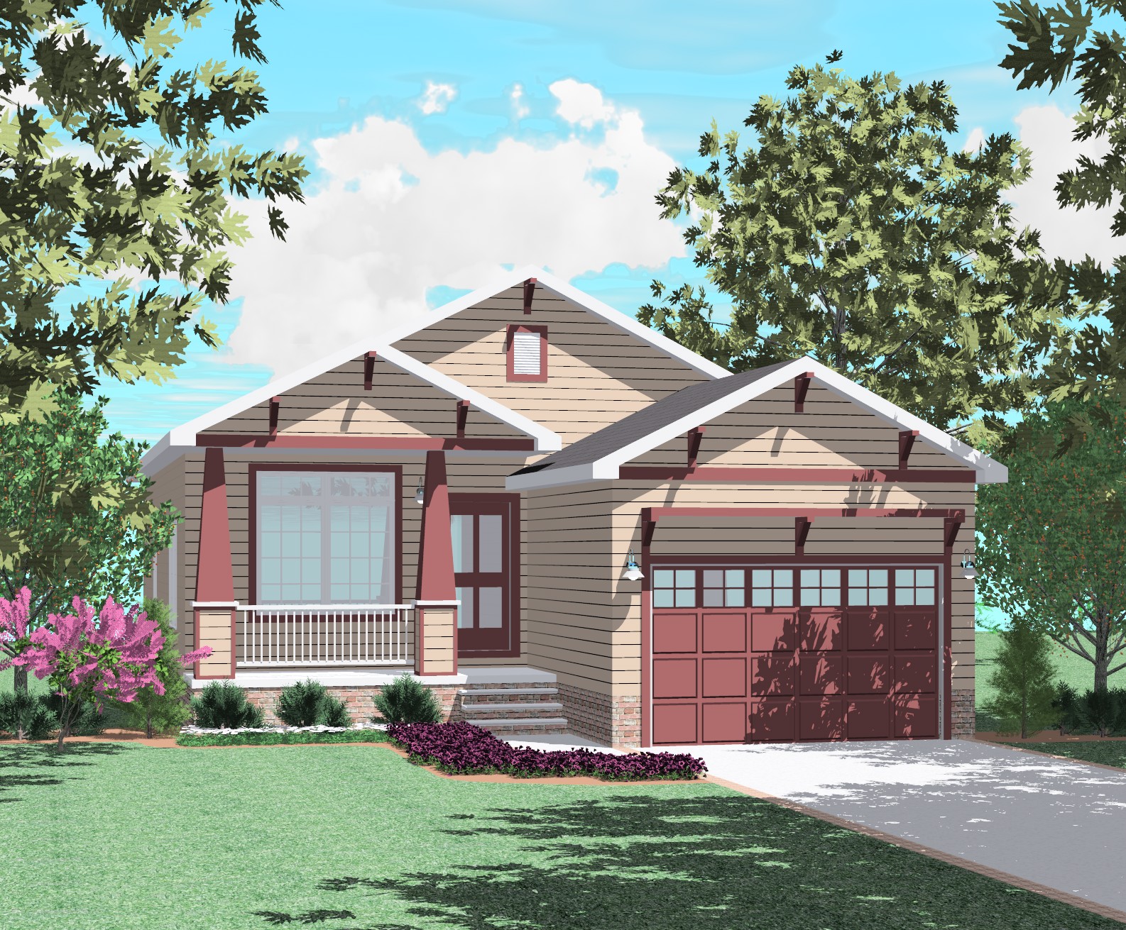

I'm working a project where we'd like to use a tapered wood column but I have no idea how to create one.  I haven't found any existing ones either.  Any ideas?

I recently had to design an Arts & Crafts style period home with tapered columns on the front porch, so  I used the pyramid mass and edited the family to the size and shape I wanted.  I don't know if this idea will work for you or not ....  Attached is a rendering.

Castle, that is perfect.  Thank you.
