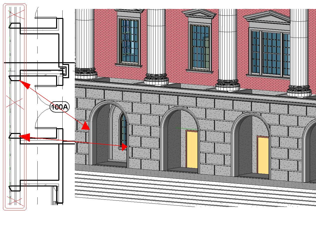

The wall shown in the photos below has the arches cut in the profile The red arrows drawn in *gag* paint [firm won't pay for photoshop for everyone] are meant as reference points to show the cast stone arch.  What can be seen in the floor plan on the left is that the wall continues, unbroken or bothered by anything.  Those "stones" that are seen in the 3d on the surface of the wall are made by a family subtracted from the wall.
 We can't plot these plans with the wall showing unbroken, it normally has shown with the breaks where those arches are, so why, now, is it showing this way?

Have you considered using a Plan Region and setting the height to just aboveor below the arches?
