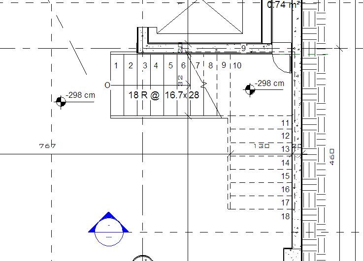

i can't put spot elevation on landings upper from my cut plane..any idea?

Try again - use the "spot dimention" and it will put the correct spot for each stair, so it should work for the landing too.

sorry - create a region plan just around the stair and set the cut plan above your landing
