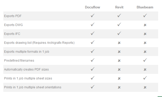

There are many PDF writters in the market. Some are free (BioPDF, CutePDF, etc); others include more complete suites to enable editing the PDFs (Adobe Acrobate, Bluebeam, etc) and they are expensive if the intention is just printing PDFs.  Bluebeam even includes a plugin for Revit. Windows 10 also comes with a Microsoft PDF printer, however this solution presents many errors inside Revit (we have tested with Revit 2017) and the print manager on the first run has some greyed controls, then the driver also needs some extra work to enable large formats, etc.

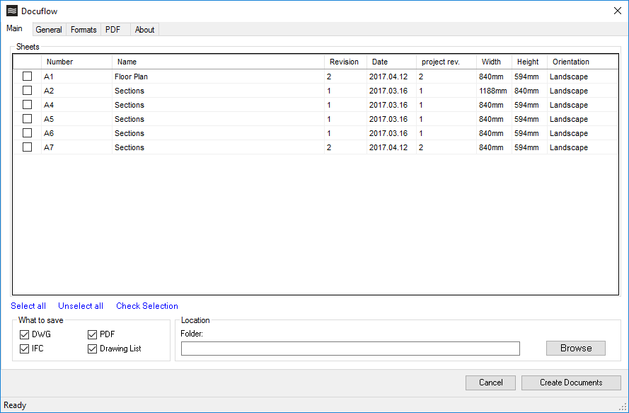

I our work as architects in Norway we have quick and dynamic relationship with the construction company, updating documentation after the products agreed with the client, therefore we send drawings to the building site very ofter: at least once a week! That includes making PDF, DWG, drawing list and IFC.
We have therefore created a Revit plugin to streamline the creation of building documentation: Docuflow. Among many features, this plugin enables to create PDFs of a selection of sheets, no matter the size or orientation. The process is several times faster than printing using the default print manager from Revit. It prints also 65% faster than Bluebeam on our tests. The reason why it is faster is the code is optimized in many rounds with the print drivers, no dialogs are presented during the process, so that the documents can be more quickly finished.
This plugin is as our other plugins tested internally and by Autodesk. You can check the features in trial version is available on the download section of our website or on Autodesk App Store.
