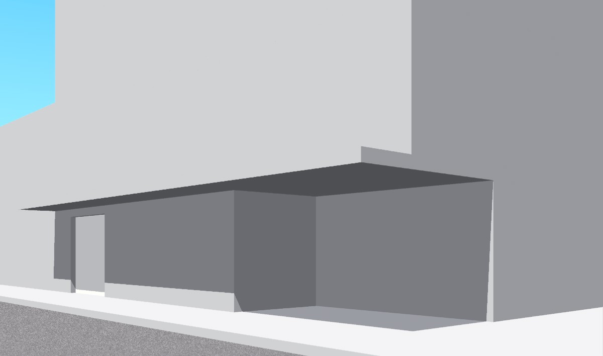

When I render my project none of the materials get rendered. Everything looks like a gray shade. I have attached one of the renderings so you can see how everything comes out gray and white. Any suggestions?

In order for Revit to render you need to specify render materials. You will find this setting under “Materials”. Under the "Appearance" tab you'll see the AccuRender box. Click on the dropdown and chose a texture. You can apply a different AccuRender texture to each material.

Thanks. I thought I had my materials assigned, but I guess I didn't.
