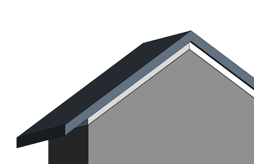

I want to put a freize board where the wall meets the roof. I was going to use wall sweeps but I can't figure out to get the wall sweeps to angle where there is a gable roof. Is this possible with wall sweeps or do I need to look at doing it differently? Any help would be appreciated. Thanks.

The best way I found is to use a roof fascia sweep, attach it to the outside edge of the roof, then you have to manually move it against the wall.

There is a vertical profile offset that can be used to move teh facia up/down in relation to the roof edge.

How do you move it back to the wall @ gable roof locations?
This user is offline |
There is also a horizontal offset but your question suggests you need a different solution. Attached is a simple in-place sweep that will automatically join at the corners.
