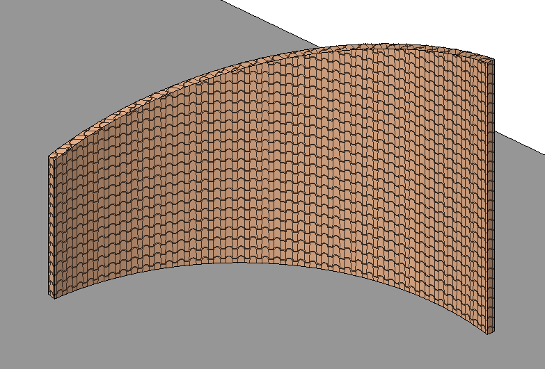

Thu, Aug 7, 2008 at 2:17:30 PM | A Sloped Curve Wall
AbelGoddard
AbelGoddard Avatar
Joined: Fri, Mar 28, 2008
15 Posts
May have worked perfectly for HIM, but see attached for what MINE looks like. NOT perfect.  :-(

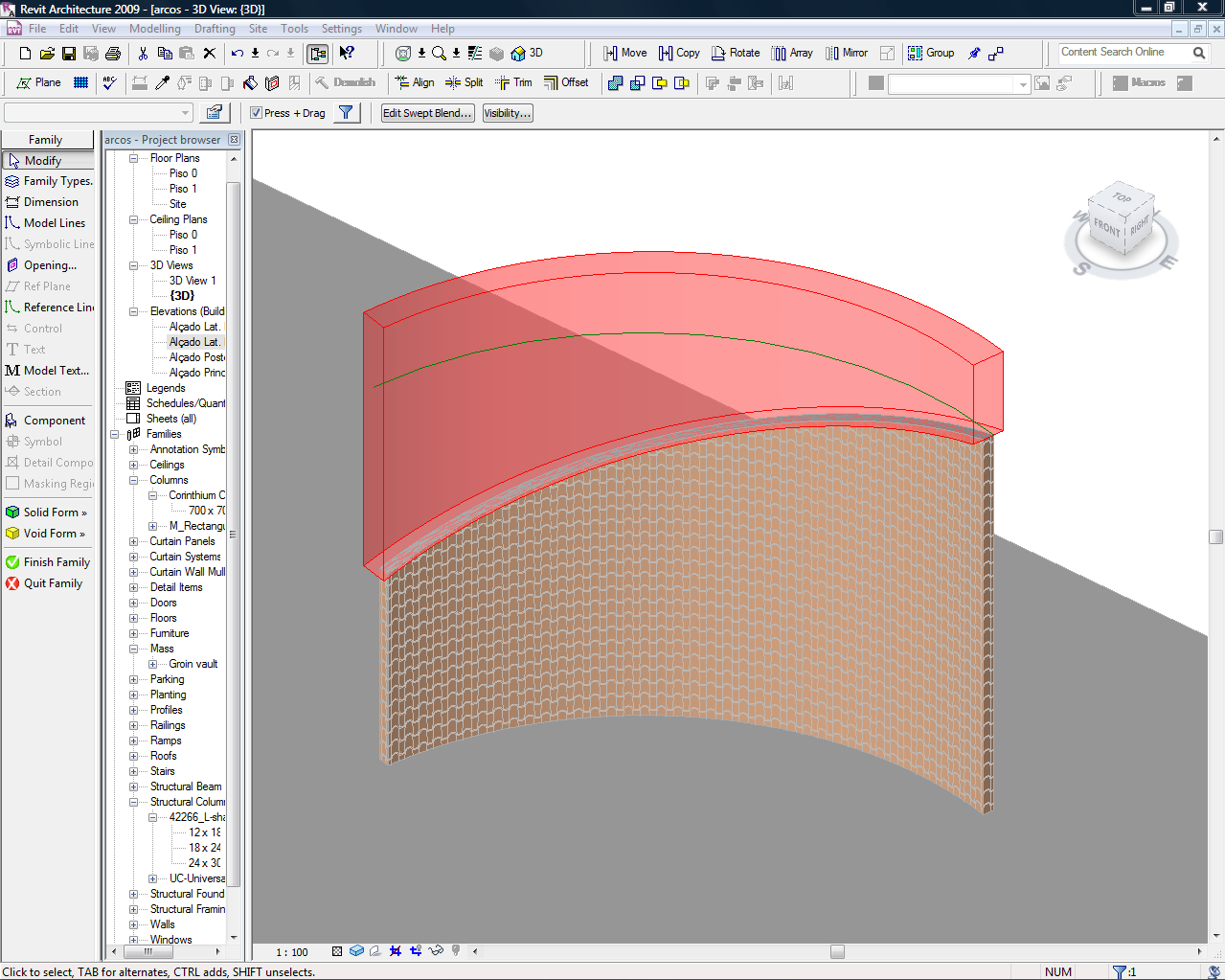

Thu, Aug 7, 2008 at 3:52:25 PM | A Sloped Curve Wall
Abel ... you found out what happens when you take the advice that was given.  You want the top of the wall flat across the normal (pirpendicular) and the previous advice will not do that.  In 2009, you could create your wall as an inplace blended sweep.
Thu, Aug 7, 2008 at 4:16:53 PM | A Sloped Curve Wall
Joined: Tue, May 22, 2007
5921 Posts
4 Stars: 205 Votes
Hi abel, you dont need REF PLANE or REFERENCE LINE, WWHUb was right, a "Void Sweep"solve the problem...
Thu, Aug 7, 2008 at 4:17:27 PM | A Sloped Curve Wall
coreed
coreed Avatar
Joined: Fri, Feb 10, 2006
1874 Posts
4 Stars: 16 Votes
i like the inplace blended sweep suggestion also.
