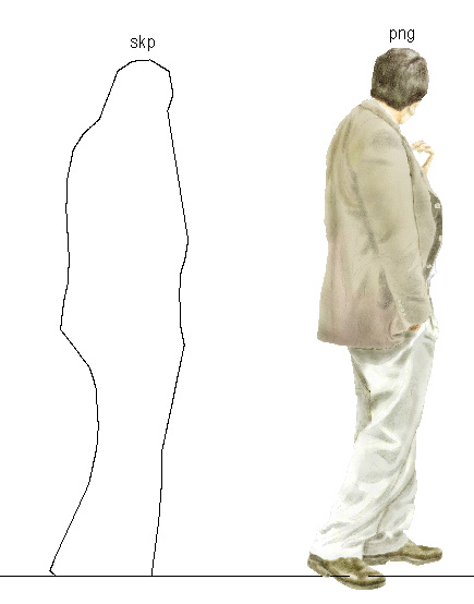

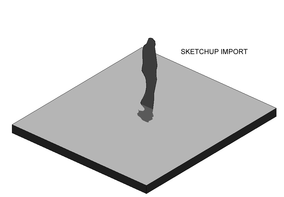

Hi Susan, With the SKP file (see attached) you don't get the actual image showing up so you only see the silhoutte of the person, which is rather difficult to make out as a person. Would be alright for schematics. Also the scale of the file? What is it? I tried importing in as millimeter which made it a scale of 0.08333 which i had to scale up to 24.0 before it was human scale. The PNG alpha's work great for elevations, their only issue is in revit you can set an image as a foreground of background. So you can't set it in front of some elements but behind others... PNG files also can't cast shadows in revit. Probably the best solution would be to combine the skp and png file to create RPC families in revit. That way the skp file could be set to show in shaded views and the png file to show in rendered views, which will cast shadows. I hope this is helpful.

Here is a screenshot of the elevation.

Hmm. The SketchUp file does have the image attached to it. So either Revit isn't importing it correctly or there is some setting issue. It is a SketchUp component and the size is set at about 6 feet. So again, there has to be some sort of setting issue. In SketchUp the component texture has to be low res because too many hi res textures would choke SketchUp. However,if a final view is selected with no expected rotation and a nice rendering required, it is easy, in SketchUp to reload the applied texture and apply the high res PNG version instead. But if you cannot import a SketchUp Component or Model with the textures attached in Revit, that doesn't do much good. Does Revit handle only RPC"s properly? I guess there is no MAC version of Revit then. Is there no Revit native format to convert to that would work properly? Thanks Chris for your help.

I'm sure it does has the image attached to it. What i meant was Revit can't take advantage of it in this manner. Revit cannot apply textures in a view without doing a rendering of the view. Revit's shaded views are limited to surface patterns and colours, to show textures you must render which takes a significant time.
If you want the image to show correctly when rendered then yes it does have to be an rpc. No there isn't a Mac version of revit.
The Revit native version would be a RFA file.
This RFA would contain the simple flat extrusion of the entourage element (in order to cast shadows in shaded and hidden line views). You could also add some 3d linework on the surface of this extrusion to further define what the form is. Entourage "families" (these are what the native format for content in revit are named) can then have settings to render using an external RPC file. RPC files can be created using free software as 'Mr GG' once showed.
I think you could use the PNG file to create the RPC file given that it has transparency abilities.
