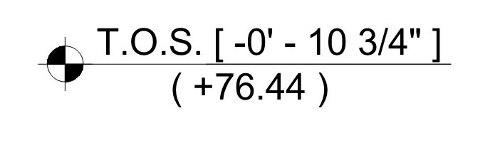

I would like to see spot elevation which could show relative and absolut elevation of floor or other element or if I coluld to choose to show me elevation of top of concrete slab and floor finish separately

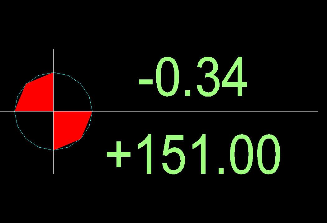

This is my first time posting. Has anyone figured out how to have a spot elevation that shows both relative and project elevation. I've attached 2 images to illustrate what I am looking for.

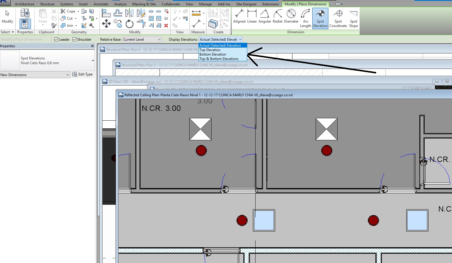

I knew I had seen this question before.  Here is one answer.

and the other part
Setting a manual height for Spot Elevations in plan
