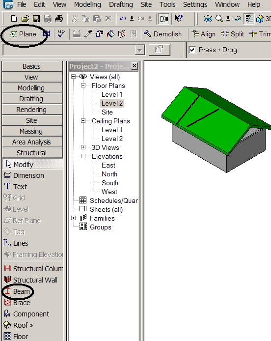

how do you rotate structural dimensioned lumber? Trying to creat beams for angled roof/ceiling and revit won't let me rotate the beams.

I hope that I have not missed something in your question!!!! I made a roof and then clicked the Plane-button and I could pick a plane of the roof then use Beam-Button on the Design Bar to place two beams in the roof and rotate one of them in the plane of the roof No problems but perhaps I have missed something in your question????
