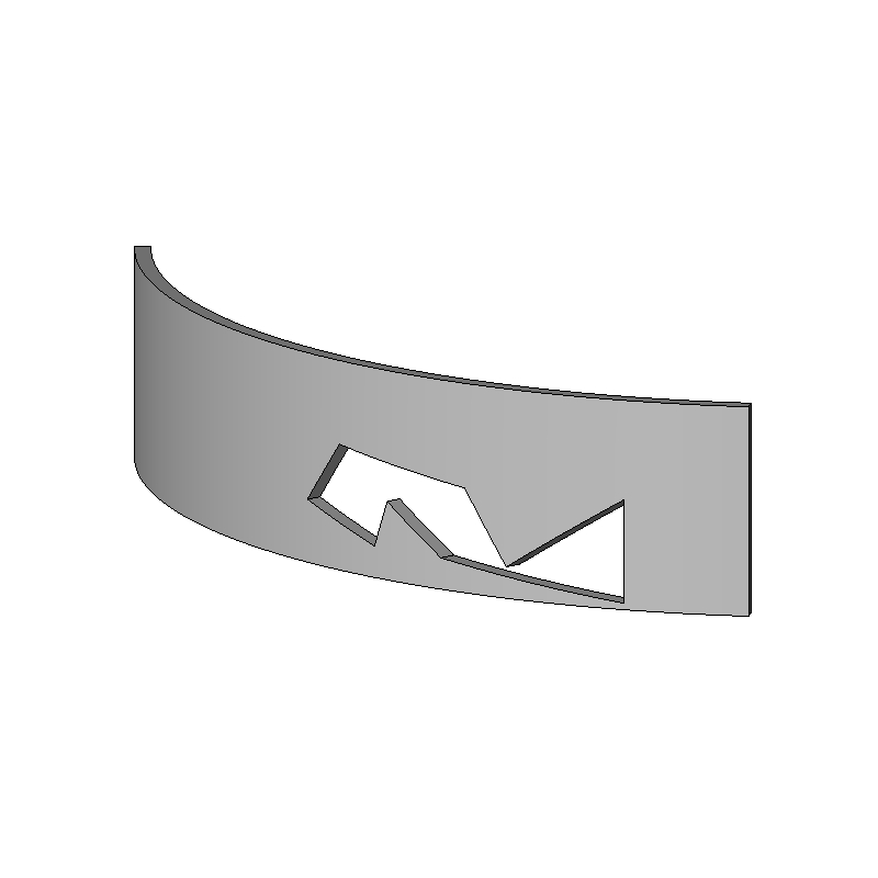

is there a way to cut curved walls by a shaped opening (triangular or curvy linear).. edit profile works on straight walls but not in curved ones.

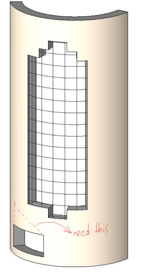

DO YOU MEAN LIKE THIS? Smile all you need to do is draw a reference line in plan, infront of you wall, set the work plane to the reference plane yo have drawn (top left button it's called "Plane"Winking it will ask you what view to open, if you have a section line infront looking at your wall in elevations, pick it. create a void family, draw your shape and make sure you cut the geometry off the wall when you finish Smile HTH Post edited on 2006-08-21 17:29:51

thank you..it worked.

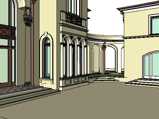

mmetin, For some shapes you may want to create a void blend so the opening flares to follow the arc. Play and have fun! This is one of the most useful tips I ever stole from this site. ;>Winking Yours, Aubrey

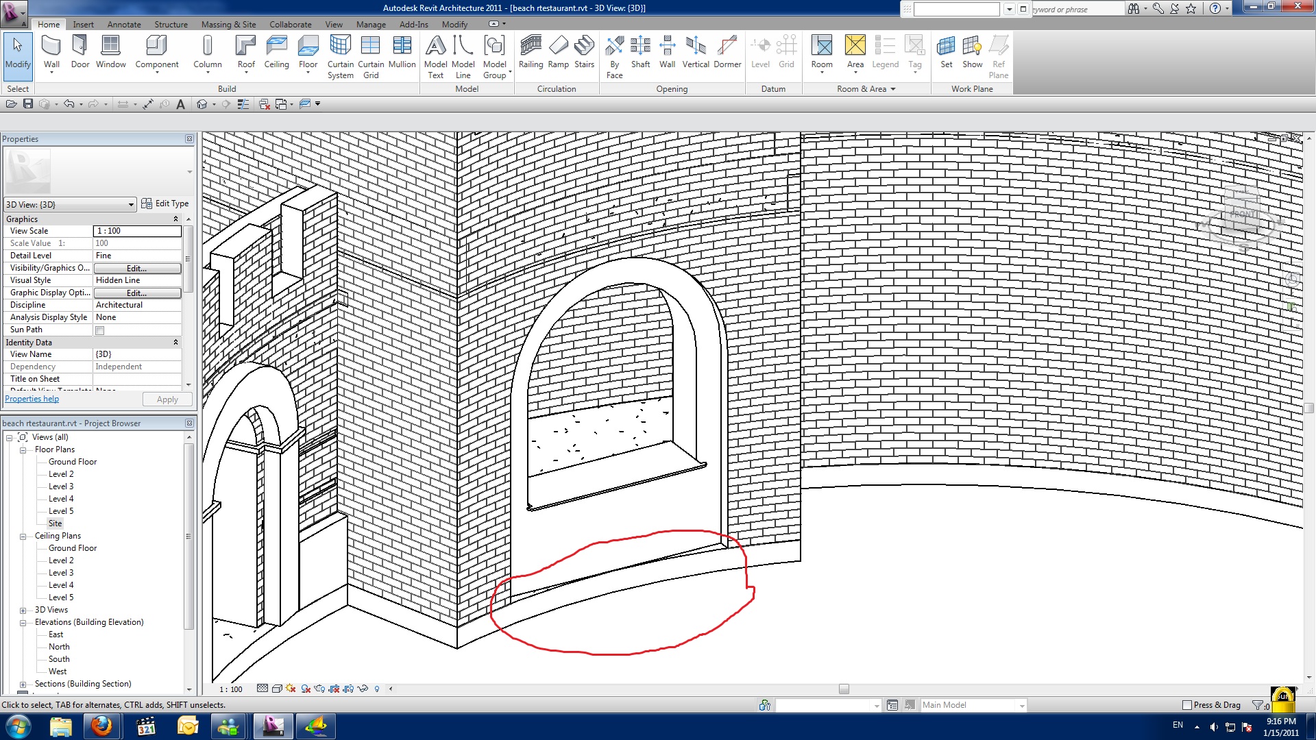

I can't make a recess in the wall to be curved the same as the original wall.what i did in the attached photo, is a Family , void object cut in the wall to form arched opening,but the result is what you see , any ideas
