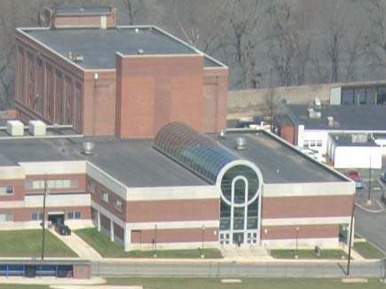

Can anyne tell me how to create an arched skylite approx 100' long with a 25' diameter like the on in the attached image? Any hel will be appreciated. Thanks in advance. J

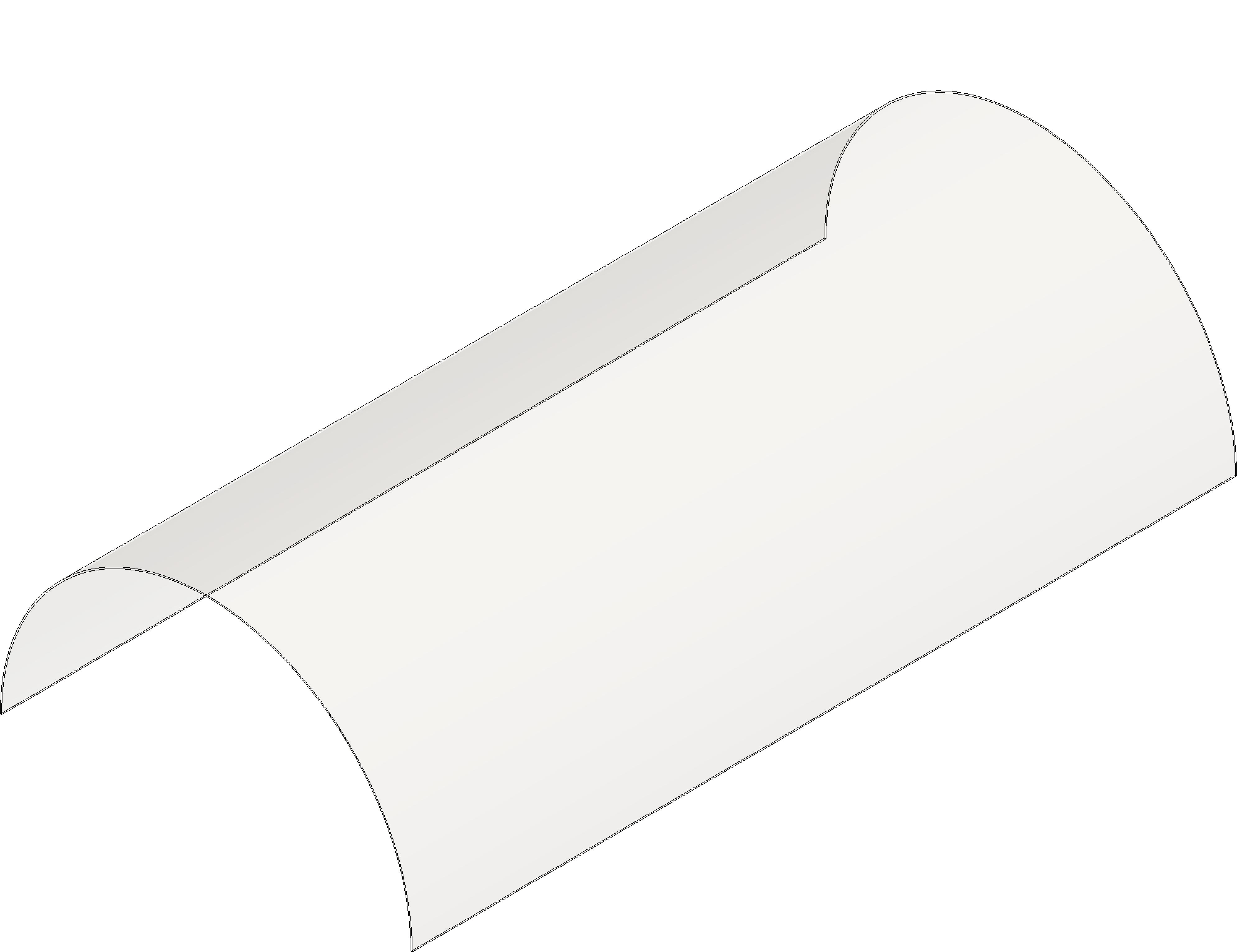

Hi Jweber, I would suggest you look at doing a roof by extrusion and choose the roof material as glazing. Kune

Here's a jpg. To get the ribbing I would create a series of the arched glass with create in place extrusions, 2" in width, between. You could then group all the pieces together for one form. Hope that helps you. Kune Post edited on 2006-08-18 14:08:22
