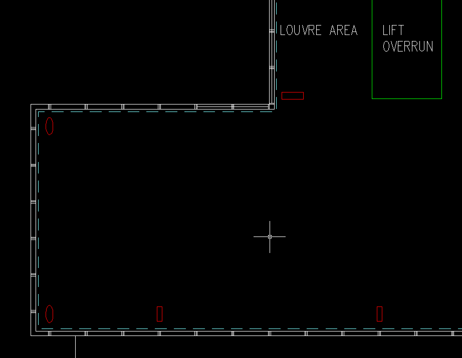

Will you be able to paste a picture of what you need please Post edited on 2006-08-15 05:19:30

This screen shot from AutoCAD is the best I can do really. As you can see there are 2 elliptical columns (towards the left) they are 300mm diameter width and 700mm diameter height.

Ive only quickly created this one, tested changing width and height parameters, so that seems fine. You obviously still need to do something about material properties.
