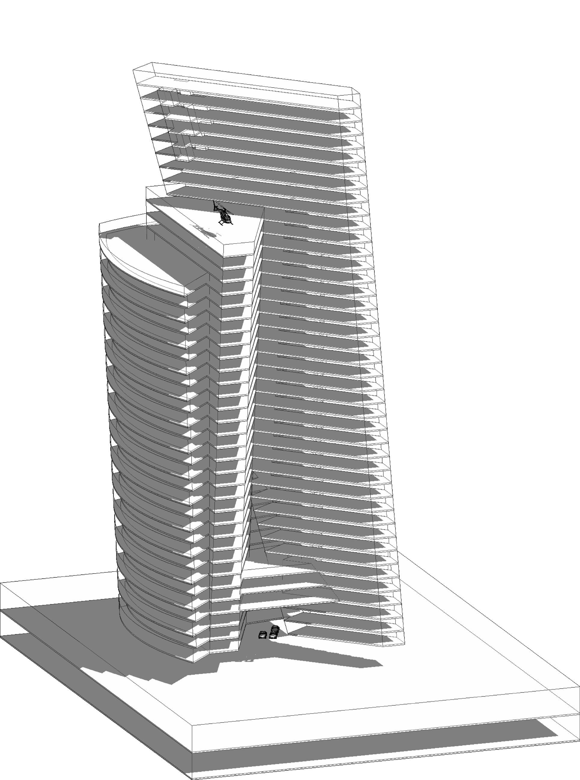

Thu, Aug 10, 2006 at 6:59:41 PM | RE: Typical Floor as a Linked Revit File
Steve_Stafford
Joined: Fri, Dec 12, 2003
114 Posts
5 Stars: 2 Votes
This is a building made of massing and floors by face. The massing can make short work of undulating or leaning buildings slab edges.
