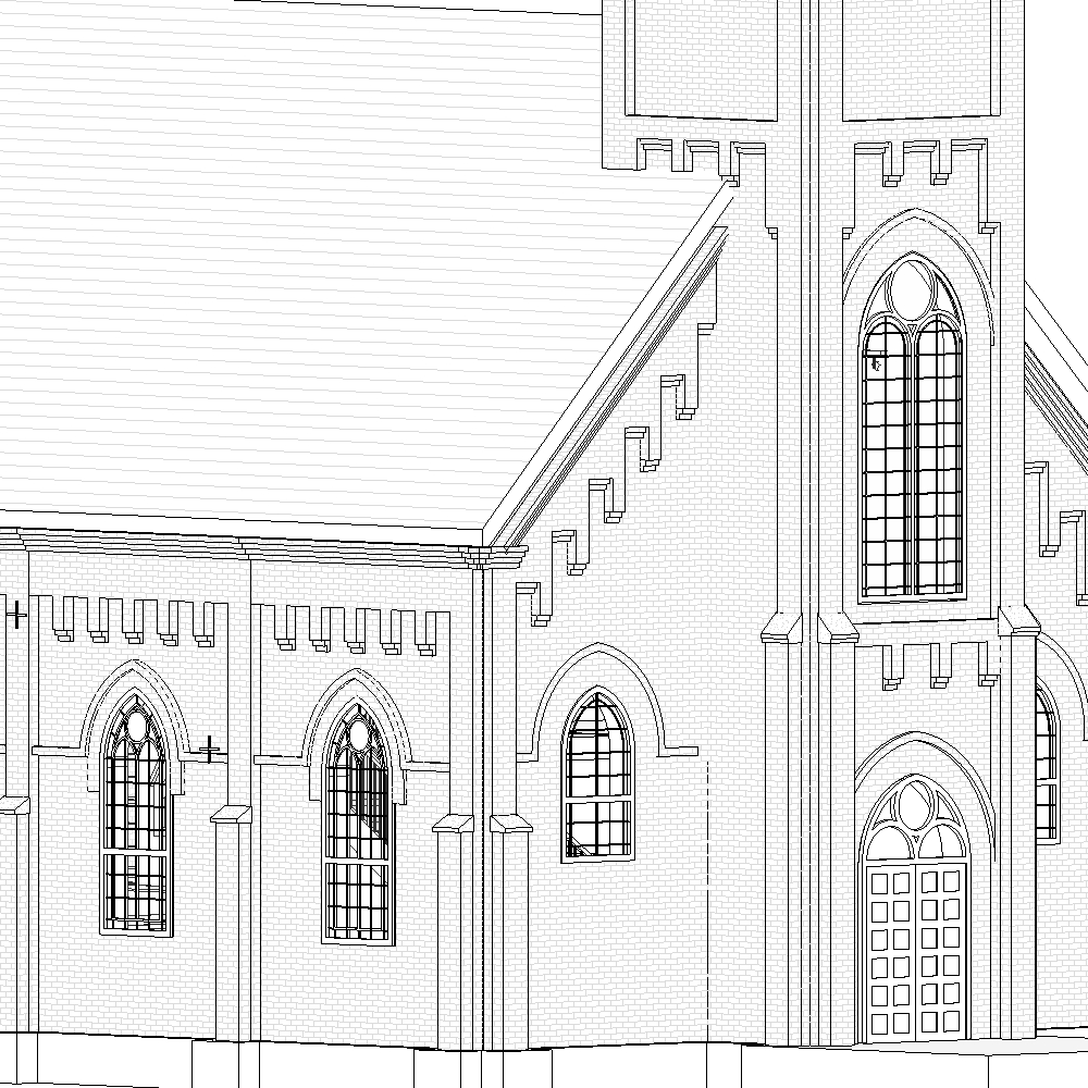

Attached is a word .doc with before and after views of a 1896 Catholic Church 2003 Renovation in Atkins, Arkansas. We had no existing drawings whatsoever and created the "after" view of the Church with the new steeple from plan measurements and photographs. The only major mistake was that we slightly missed the roof slope on the main roof. We found that taking photographs of existing elevations or windows, inserting them as .jpg's, scaling them to one correct dimension, gave us a template to create window, louver, and brick detail families. This was created almost three years ago and we did not know how to create the gothic windows as window families so they could be inserted and the wall would fit around them. We had to insert them as generic families and "cutout" the wall profile to fit around them. Once they are properly created, you have them forever to modify and use on the next project. Hope this helps.

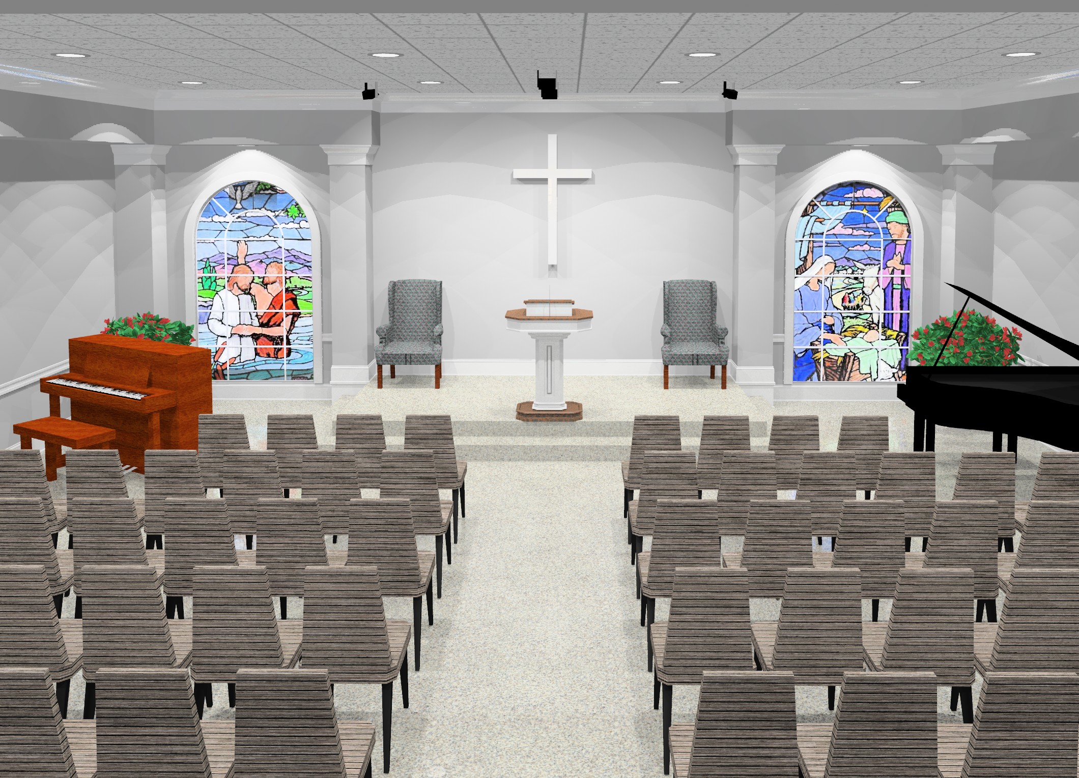

Attached is a .jpg image of an interior new chapel rendering. The pulpit is an exact copy of an existing one they wished to re-use in the new chapel. It was surprisingly easy to create as a family object using the sweeps and solid modeling in that family. The stained glass windows were created using .jpg's downloaded off of the internet as decal inserts. You insert the image into a generic family. You scale it to the desired size. You build a solid wall of a thin material (doesn't matter what since the decal will cover it), attach the scaled image as a decal to the wall, then edit the profile and cut it to fit the part of the image you want to see. When rendered, only the parts of the decal that have something to attach to will be rendered. The rest, where there is no wall behing it to attach to, will not show in the rendering. You could do the same thing with window photographs to render the existing stained glass or the existing view outside that window. We created the mullions of the window as thicker solids and made sure that the stained glass image wall and decal were thinner and inserted behind the front edge of the mullions. Hope this helps.

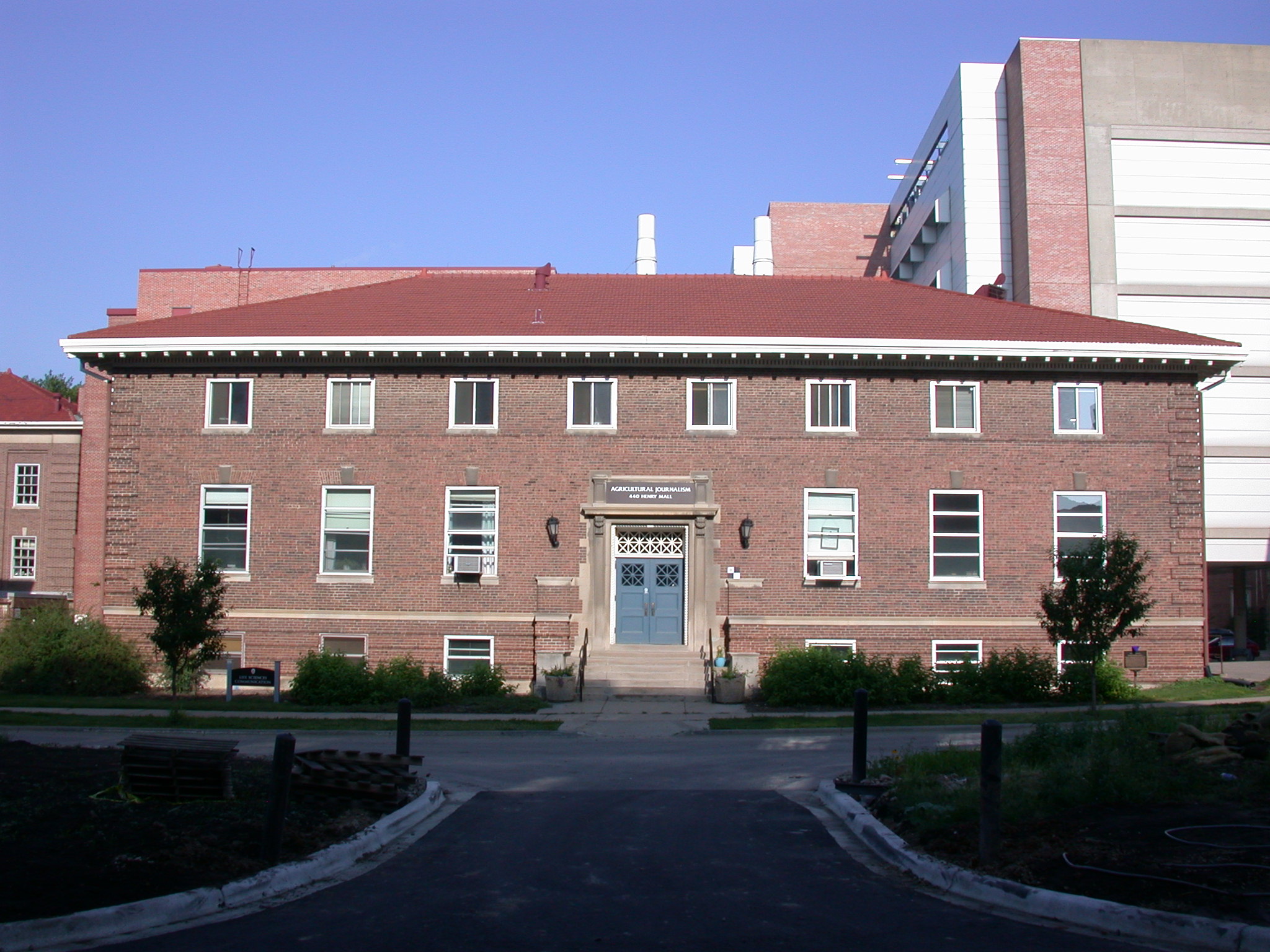

Thanks so far. These are helping. However, at this point, renderiing is the last thing on our minds. Where I am at right now is that we are working on a existing university building from 1907. We went out and did field measurements and took photographs. I started by drawing wall sections in Cad. We really don't have what is exactly in the walls, but we have the heights and widths of the walls. Now, I am trying to create what I know in CAD into Revit. I am looking for accurate elevations and floor plans. The brick pattern on the outside of the building is very irregular with different size bricks and mortar joints to match. There are quite a few sweeps and reveals on the walls too, but the corners of the buildings have brick quoins. How would I go about creating this building accurately? I attached a picture of the front elevation if that would help your thinking process any. Thanks a lot.

You can add sweeps to your wall to recreate the cut stone looking band and the protruding brick looking bans. You will probably have to create a new sweep profile to match your existing and load it into your door family. The quoins will have to be a generic shape that fits the design of your existing quoins including enough depth to disappear into your brick veneer. You then insert one into your project and mirror, array, or copy it at each corner. You can probably find a window to match your design and edit the sizes or you can create your own window family. Create the keystone and lintel brick as a separate family and insert it into your window family or just insert it into your project and copy. Be sure that the inserted keystone and brick lintel is just in front of the edge of your brick veneer so it will show correctly. The brick lintel will probably have to be separate bricks with mortar solid infill. Be sure that the material selected for both matches your project materials. Accurender has some blends of brick veneer images that come close to yours. The dentil moulding at your soffit is a big pain. The only way I have found to do it is to create one and array or copy it all over the place. I notice that there is a real good clay tile pattern recently uploaded to Revit.City that you could use for your roof pattern. If you try to create 3D individual roof tiles, it will be a huge file. You will have to create the ridge and hip tiles and insert them on the roof. You will just have to create the entry steps and precast door surround as a separate family and insert them. You will also probably just make the door as a solid generic family too and draw fake door swing lines on your plan. If you want it to be recognized on your schedules as a door, you will have to create a new custom made door family, place a wall just barely larger than your door into the opening of your entry precast, and insert the door into the wall. Attached is a hidden line B&W view of the Atkins Church. Hope this helps.

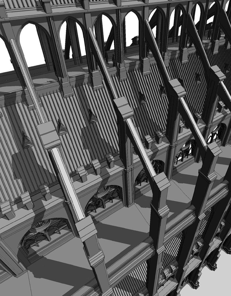

Hey guys, I know Im a bit late into this thread - but nice modelling! That church is looking fantastic! We also have used Revit to extensively model existing buildings but as Hogmodo is saying, you tend to base it off 90% photos and 10% key measurements. You can model pretty much any architectural form on Revit, and the more you do it the more it feels like youre just sketching stuff. The attached pic is of a hypothetical cathedral I've been playing with. It only takes one of these to teach you Revit modelling...

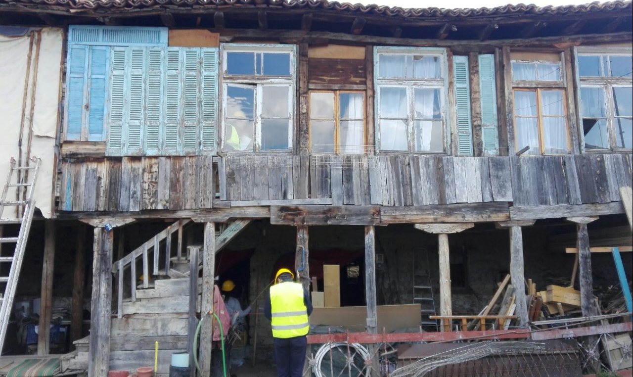

I have a project for my faculty and i would like to hear your opinions. We have to measure and then make the drawings of a very old building and i
Am not sure if revit is the right program to use for modelling. Attached you will see a photo of the building. Thank you in advance

I would never attempt to model this.
For work like this, I prefer photographs placed on my sheet where I can tag and indicate the work to be done.
