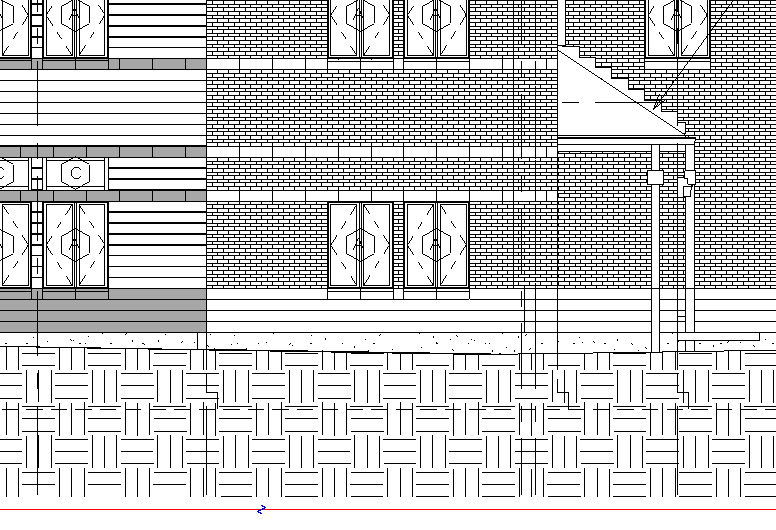

Does anyone know how to, or if it's even possible to show only the Grade line rather than all of the Earth Hatching plus the grade line when you have a toposurface in your model?? I've been able to turn off the topo lines but not that pesky hatch

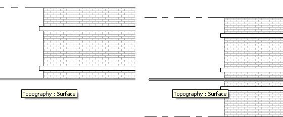

One step further...Now that I have the hatch switched off.  I can't see object beyond the cut plane.  I have extended the viewing parameter (green dashed line), but is all blocked out where the hatch used to be.

Im sure there is a better way, but you could right click the surface-->override graphics in view and select transparent. It will only be transparent in that view, so if you need to do it in many views, it may be annoying repeating that step. Is that what you wanted? Refer to picture
