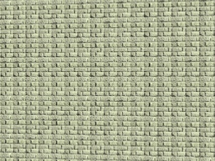

Hey guys, ive been looking for a coursed split / pitched faced natural stone (as show in the link) texture for months for a project. I cant seem to find one anywhere. Iv'e looked in colleuges computers whom have viz etc but even they dont seem to have one. Any pointers etc would be a lifesaver! http://www.stancliffe.com/architectural_masonry.htm

Why can't you save the picture off that website and then just crop it. I tried it and was able to set up a new user material using the .jpg image. The attached is the results after I rendered it. I didn't mess with the color or anything but I think you can step up several different colors like all the other materials. Let me know if I am wrong about this.
