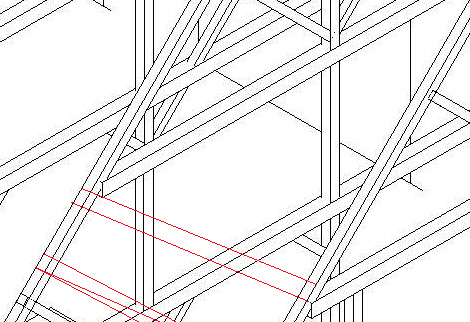

I am trying to model a roof where I have to add horizontal beams that follow the angle of the roof. At the moment, all beams seem to be locket at a vertical axis, although you can have the ends at different heights. How can I tilt a beam?

Try adding a reference plane at the roof slope, name it (properties), then set work plane to the newly named reference plane then place the beams. HTH Tom

Thanks, Tom I am new to Revit (my second week now) and of course it worked with reference planes! Thomas
