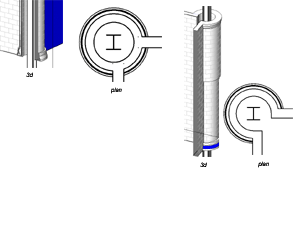

Hi, Just got Revit and I have a question which, as yet, defeats me. Can Revit create a cavity wall "around" a steel colum to create a brick pier without having to create two single-skinned walls? I have included a picture. Thanks in adbvance.

I really think the best method would be to create a single skinned brick wall around the column as you first thought. If you setup the brick as priority 4 or 5 finish layer (in both wall types) they will trim together properly.

Those columns are families created outside the project. FILE >>>> NEW >>>> FAMILY >>> and create a column as an extrusion with the center cut away. the family template you're looking for is "Column.rft". You can set parameters to this to control wall thickness and all that good parametric stuff. Again this method is just an option try it out. See attached Post edited on 2004-09-26 12:38:17 Post edited on 2004-09-26 12:38:29 Post edited on 2004-09-26 12:46:18

As shown

Priority, that looks superb, thanks for taking the trouble. I'm trying to replicate what you did and I'm sure I'll get there. At least now I know it's possible. Cheers.

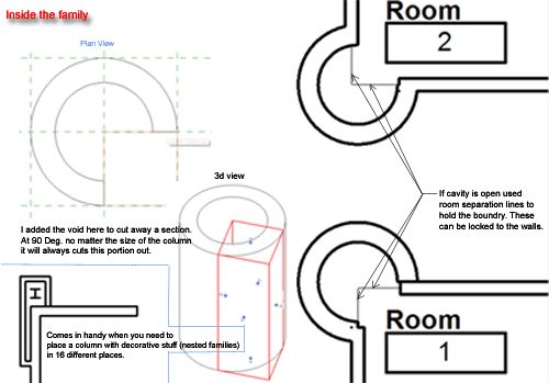

Hi all, esp. Mr. Priority Sorry to bother you, but your help with the brick piers and cavity wall intersections was very encouraging. Problem is I still can't get my head around it. Believe me I have tried. I have played around with wall layer priorities, tried to make a family, intersected a cavity wall with a single layer wall and a multi-layer wall with a very thin core (etc. etc.). I also tried to make a family of columns with a hollow centre but I could not seem to allocate wall-type material i.e. have it multi-layered like a regular wall. In the attached picture I assigned the outer brick of the wall to be priority 5 and the brick of the pier to be 5. I got the trimming behaviour that you see here. Obviously I also need the red shaded areas to be removed to achieve what I need. If you can help me any further I'd be very grateful. Thanks. Mark (Redrose). Post edited on 2004-10-08 10:21:44 Post edited on 2004-10-08 10:23:20

I guess I could have explained a little more on How to. Sorry. This worked for me when I had multiple columns place throughout the structure. Some on corners and some….well…you know and they had some type of décor on them. Again this is just an option.
Custom Family that has user imputs
