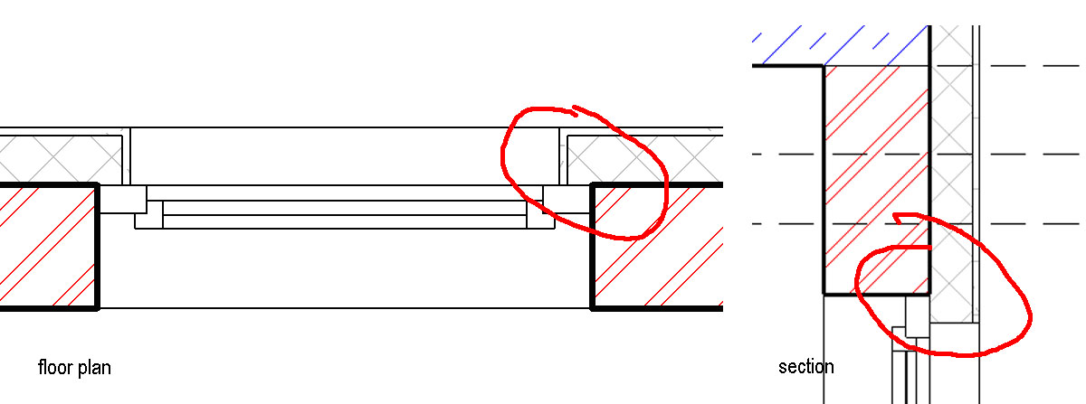

we have some problems with windows ... in the floor plan are the right wrapping in the aperture but in the section the wrapping don't works !?!? can you help us about the problem, see also the picture in the attachment

Wrapping in section has not yet been implemented into revit for finish layers. Either draw a filled region or include the wrapping material in the window family. HTH.

Hi, you can use the edit cut profile tool for high detailed sections. Thanks to Giovanni D'Ambrosio (aka Gioda) of http://www.3dsmile.it for this tip.
