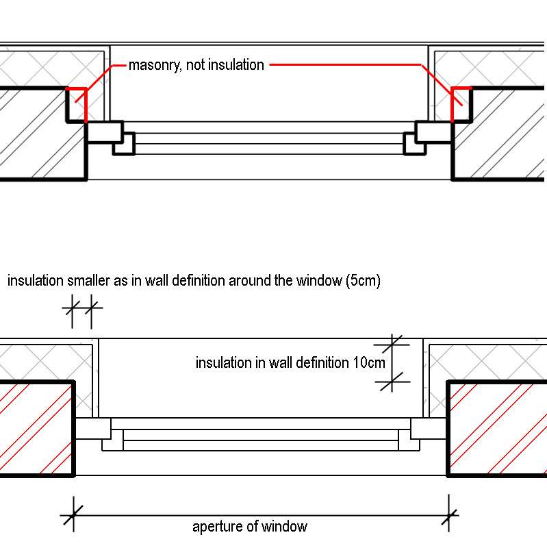

we have some problems with the connection of window and wall can you help us to change the wrapping like in the picture of the attachment

as mentioned in your other post, wrapping is one of the weak spots of revit. If you require this much control either create the wrapped segments as separate walls or include them in your window family (better option) HTH.
