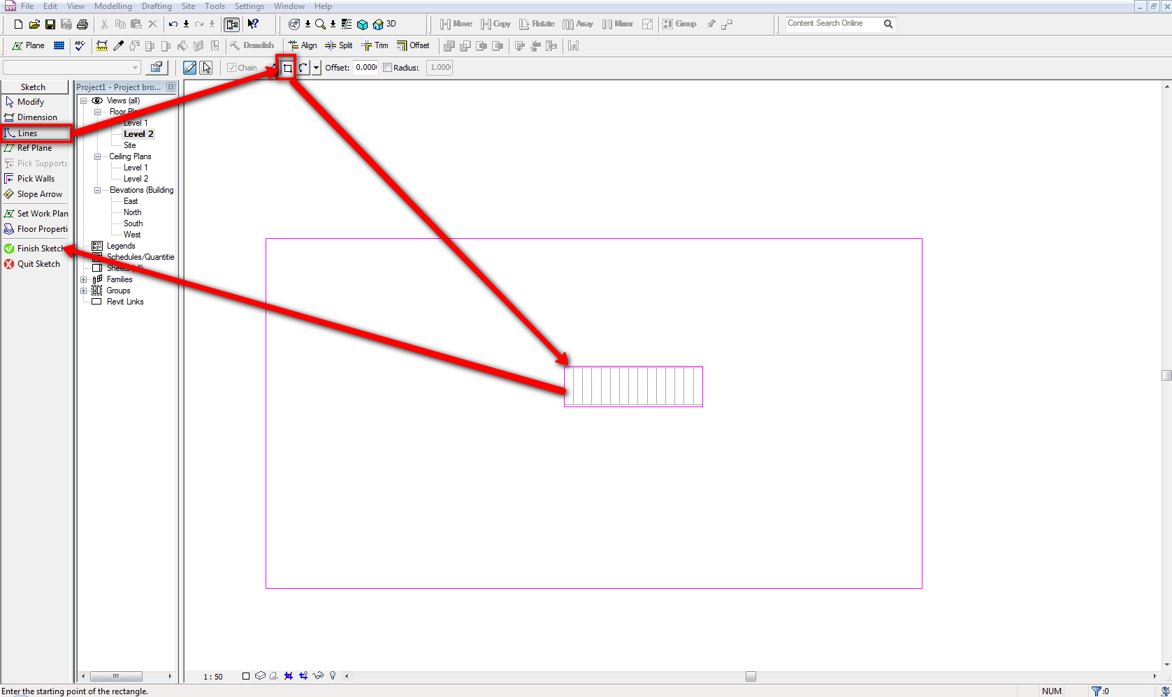

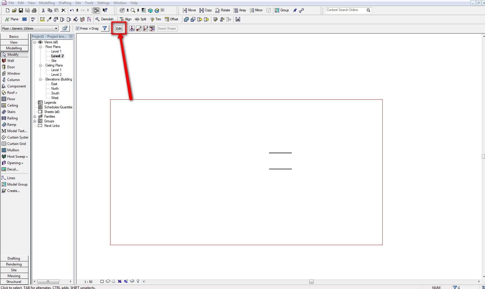

hey guys i am newbie aswell i cnt create the same opening on the floor slab to accomodate the stairs whereas i can manage to do more complex things then that plz let me knwo how to do it?
 Muf
Fri, Apr 24, 2009 at 9:42:58 PM | hole in the second level for stairs?
erland73
erland73 Avatar
Joined: Fri, Sep 7, 2007
738 Posts
4.5 Stars: 85 Votes
Hi Mufu, to create a hole on your slab just edit it, sketch with lines the shape of your stairs and then click "Finish Sketch" (see images)
