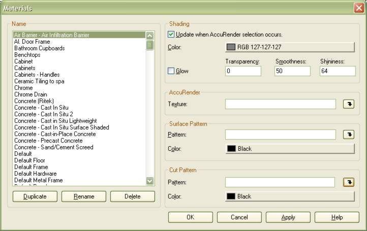

Just find the material you've set for the in-place wall family. Go to Settings - > Materials --> Find the material in the left list and select it --> Where it says cut pattern, select the arrow at the far right and select an appropriate pattern, in your case solid fill. Then select a colour for the fill. There you go.
