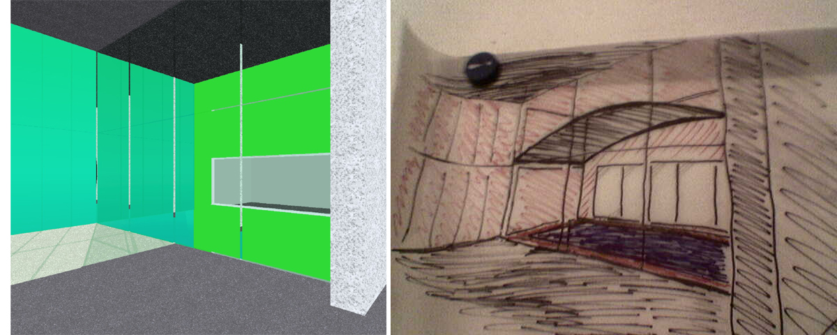

Hello peeps, I'm a new revit user, and I realized to make a model, but I haven't found a way to make an arched roof a attached a file so you can see what I'm talking about

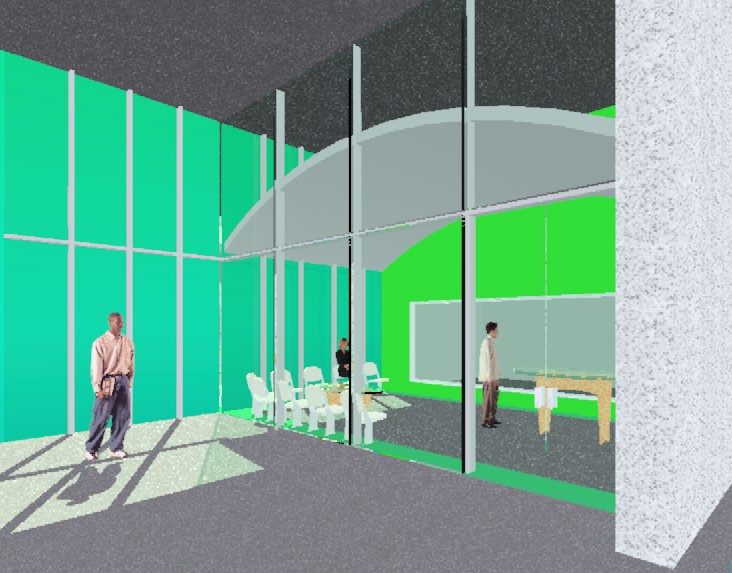

No Worries. When you create a roof you have to options in which to create it, by footprint or extrusion. If you go to a section view parallel to which the roof is to extrude and create a roof by extrusion you can draw the curved profile. Then simply just select your start and finish points for the extrusion. You may be asked to specify a work plan to start out, in this case just click on a face of one of the walls in the section that is parallel to where the roof is to extrude. If there is none, draw a reference plane in plan and specify that as the work plane. Sounds difficult but it isn't. If you need more clarification look up roof by extrusion in the revit help... Hope this helps. Cheers.

Thnx a lot, I managed to do it.. I attached the finished model
