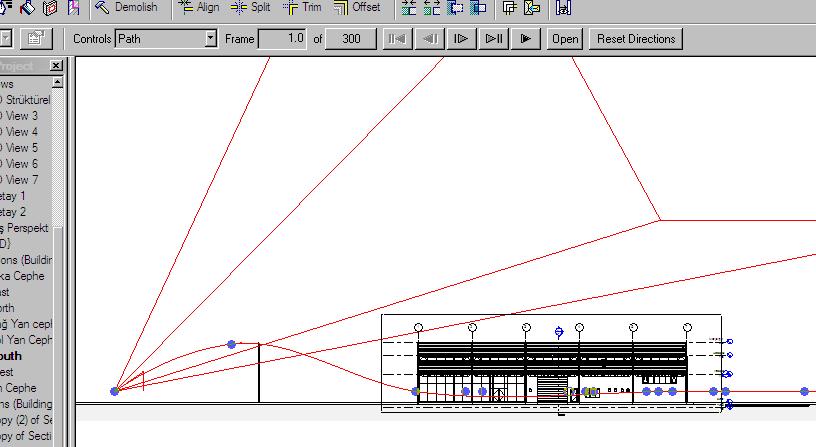

hi....go to any elevation..open the walkthrough camera(in browser right click on walkthroug 1 and click on show camera)...when you see the key frames and camera points in elevation click edit (upper bar)...and edit key frames by moving up or down....be careful about the key frames..(they may overlap and may cause you change wrong key frames.) ....Loves From TURKEY.
