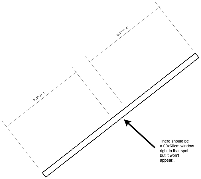

Good morning friends... I've been having this problem with windows... It seems that sometimes when I pick a window, and give it new Height, Sill Height and Width values, it just won't appear on my plan view... And it does exist there.. What could it be?

Check the cut plane settings for your view. It looks like your window is located above the cut plane. If the cut plane should be cutting the window check the family. In the family set the sill height and window height as per the project and see if it appears the same way in the plan. If so, adjust the cut plane in the family then reload it into the project. HTH.

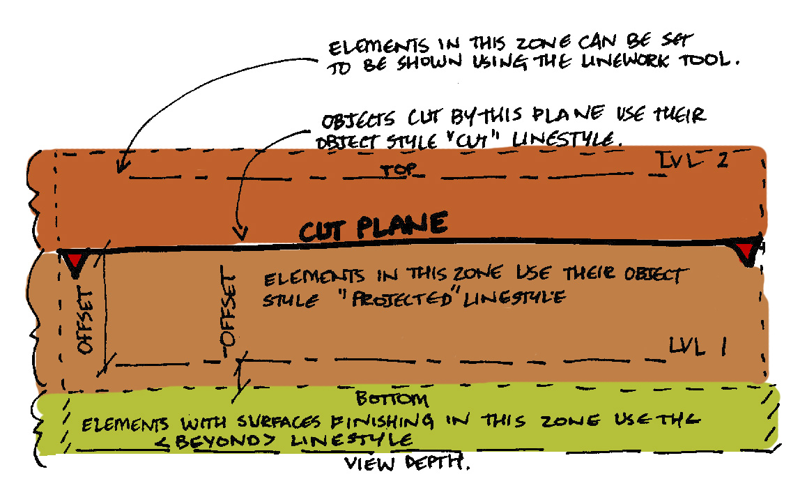

For odd elements you can setup plan regions to independantly control the cut plane for a small section of your plan for a given boundary. Please look at the attached sketch which explains the view range settings. HTH.

The cut plane is always going to affect your windows. Think of it this way, the cut plane needs to be cutting through the opening that the window makes in the wall in order for the window to display. Otherwise you are just going to see the wall hatch continuing through where the window should be.
If the 600x600 window has a head height of 2100mm from Level 1 then your cut plane would need to be a minimum cut height of 1500mm offset from level 1. If doing this causes other windows with a head height less than 1500mm not to display then you would use a plan region.
In the view tab, select plan region and draw its boundary around the 2100mm head height window that isn't displaying. Then set the view range of this plan region to have a cut higher than the 1500mm sill height of this window to have it display.
